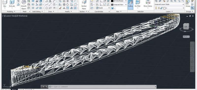

I exported this ship hull from Sketchup.
I don't know how to create a mesh surface from the following ship hull. I want to combine those surfaces to form a mesh surface. I have no idea.
After forming a mesh surface, i want to SURFTRIM to get cross sections of that ship's hull.
Have you tried the MESHSMOOTH command?
MESHSMOOTH
Convert solids, surfaces, and legacy mesh types to mesh objects.
You can use the MESHSMOOTH command to convert certain objects to mesh. Convert 3D solids, surfaces, and legacy mesh objects to the enhanced mesh object in order to take advantage of capabilities such as smoothing, refinement, creasing, and splitting.
See the topic Create Mesh by Conversionin your AutoCAD Help file for further details.
