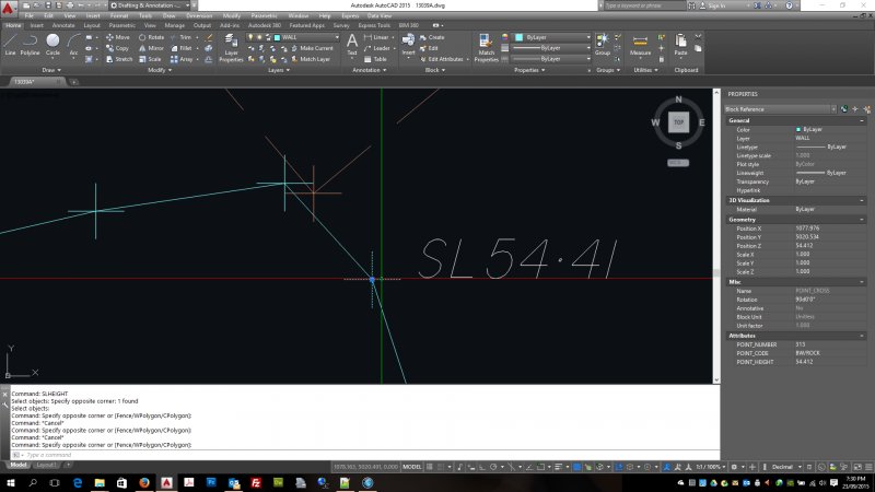

I am using Autocad 2015. I have other commands that change the USERR4 settings to the scale I need my drawing to be and therefore scales my text to align with the scale of the USERR4 settings. With the last code I just put on here c:slheight works as you can see on the picture i just added. The code grabs the height of the point and puts an SL in front of it for example if you need a surface level height on a manhole. I am in surveying so this will come in real handy.
