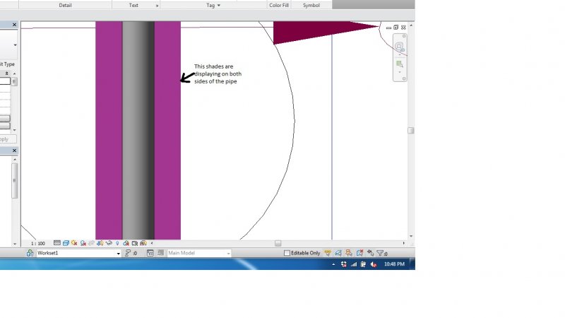

I have started working on water supply pipe project, the required scale of the view is 1:125, when i draw the pipe of dia 50, revit 2015 is displaying with on both sides of the pipe with more than dia of the pipe.
I have tried by changing the material properties, but clue for this issue.
Please suggest me where i am going wrong
Ramanaattachment.php?attachmentid=55571&cid=1&stc=1
Can you post a better screenshot, a bit more zoomed out? I cannot make out what I'm seeing.

Sorry for the late response, I have found the solution for this, This pipe thickness controlled by the system color scheme in the view properties.
Thanks for your support
