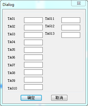

77077 Posted September 16, 2015 Author Posted September 16, 2015 (edited) Really? (strcat ": row { : text { label=\"" (car n) "\";} : edit_box {value=\"" (cdr n) "\";key=\"key" (itoa I) "\"; width = 5; fixed_width = true;}}" ) Thanks Tharwat. I mean like this : [color=RED]([/color][color=BLUE]defun[/color] [color=BLUE]editlst[/color] [color=RED]([/color]lst [color=BLUE]/[/color] fname fn i dclid lst_tag lst_val len_txt len_edbox[color=RED])[/color] [color=RED]([/color][color=BLUE]setq[/color] lst_tag[color=RED]([/color][color=BLUE]mapcar[/color] [color=DARKRED]'[/color][color=BLUE]car[/color] lst[color=RED]))[/color][color=#990099];new[/color] [color=RED]([/color][color=BLUE]setq[/color] lst_val[color=RED]([/color][color=BLUE]mapcar[/color] [color=DARKRED]'[/color][color=BLUE]cdr[/color] lst[color=RED]))[/color][color=#990099];new[/color] [color=RED]([/color][color=BLUE]setq[/color] len_txt[color=RED]([/color][color=BLUE]+[/color][color=RED]([/color][color=BLUE]apply[/color] [color=DARKRED]'[/color][color=BLUE]max[/color] [color=RED]([/color][color=BLUE]mapcar[/color] [color=DARKRED]'[/color][color=BLUE]strlen[/color] lst_tag[color=RED]))[/color][color=#009900]2[/color][color=RED]))[/color][color=#990099];new[/color] [color=RED]([/color][color=BLUE]setq[/color] len_edbox[color=RED]([/color][color=BLUE]+[/color][color=RED]([/color][color=BLUE]apply[/color] [color=DARKRED]'[/color][color=BLUE]max[/color] [color=RED]([/color][color=BLUE]mapcar[/color] [color=DARKRED]'[/color][color=BLUE]strlen[/color] lst_val[color=RED]))[/color][color=#009900]2[/color][color=RED]))[/color][color=#990099];new[/color] [color=RED]([/color][color=BLUE]setq[/color] fname [color=RED]([/color][color=BLUE]vl-filename-mktemp[/color] [color=BLUE]nil[/color] [color=BLUE]nil[/color] [color=#a52a2a]".dcl"[/color][color=RED]))[/color] [color=RED]([/color][color=BLUE]setq[/color] fn [color=RED]([/color][color=BLUE]open[/color] fname [color=#a52a2a]"w"[/color][color=RED]))[/color] [color=RED]([/color][color=BLUE]write-line[/color] [color=#a52a2a]"EditDCL:dialog{label=\"Attribute block Editor\";"[/color] fn[color=RED])[/color] [color=RED]([/color][color=BLUE]write-line[/color] [color=#a52a2a]":boxed_row { "[/color] fn[color=RED])[/color] [color=RED]([/color][color=BLUE]write-line[/color] [color=#a52a2a]":column {"[/color] fn[color=RED])[/color] [color=RED]([/color][color=BLUE]foreach[/color] n lst_tag [color=RED]([/color][color=BLUE]write-line[/color] [color=RED]([/color][color=BLUE]strcat[/color] [color=#a52a2a]": text { label=\""[/color] n [color=#a52a2a]"\"; width ="[/color][color=RED]([/color][color=BLUE]itoa[/color] [color=RED]([/color][color=BLUE]fix[/color] len_txt[color=RED]))[/color][color=#a52a2a]"; fixed_width = true;}"[/color] [color=RED])[/color] fn [color=RED])[/color] [color=RED])[/color] [color=RED]([/color][color=BLUE]write-line[/color] [color=#a52a2a]"}"[/color] fn[color=RED])[/color] [color=RED]([/color][color=BLUE]write-line[/color] [color=#a52a2a]":column {"[/color] fn[color=RED])[/color][color=#990099];;[/color] [color=RED]([/color][color=BLUE]setq[/color] i [color=#009900]1[/color][color=RED])[/color] [color=RED]([/color][color=BLUE]foreach[/color] n lst_val [color=RED]([/color][color=BLUE]write-line[/color] [color=RED]([/color][color=BLUE]strcat[/color] [color=#a52a2a]": edit_box {value=\""[/color] n [color=#a52a2a]"\"; key=\"key"[/color] [color=RED]([/color][color=BLUE]itoa[/color] i[color=RED])[/color] [color=#a52a2a]"\"; width ="[/color][color=RED]([/color][color=BLUE]itoa[/color] [color=RED]([/color][color=BLUE]fix[/color] len_edbox[color=RED]))[/color][color=#a52a2a]"; fixed_width = true;}"[/color] [color=RED])[/color] fn [color=RED])[/color] [color=RED]([/color][color=BLUE]setq[/color] i [color=RED]([/color][color=BLUE]1+[/color] i[color=RED]))[/color] [color=RED])[/color] [color=RED]([/color][color=BLUE]write-line[/color] [color=#a52a2a]"}\n}"[/color] fn[color=RED])[/color] [color=RED]([/color][color=BLUE]write-line[/color] [color=#a52a2a]"ok_cancel;"[/color] fn[color=RED])[/color] [color=RED]([/color][color=BLUE]write-line[/color] [color=#a52a2a]"}"[/color] fn[color=RED])[/color] [color=RED]([/color][color=BLUE]close[/color] fn[color=RED])[/color] [color=RED]([/color][color=BLUE]setq[/color] dclid [color=RED]([/color][color=BLUE]load_dialog[/color] fname[color=RED]))[/color] [color=RED]([/color][color=BLUE]vl-file-delete[/color] fname[color=RED])[/color] [color=RED]([/color][color=BLUE]new_dialog[/color] [color=#a52a2a]"EditDCL"[/color] dclid[color=RED])[/color] [color=RED]([/color][color=BLUE]action_tile[/color] [color=#a52a2a]"accept"[/color] [color=#a52a2a]"(done_dialog 1)"[/color][color=RED])[/color] [color=RED]([/color][color=BLUE]action_tile[/color] [color=#a52a2a]"cancel"[/color] [color=#a52a2a]"(done_dialog 0)"[/color][color=RED])[/color] [color=RED]([/color][color=BLUE]start_dialog[/color][color=RED])[/color] [color=RED]([/color][color=BLUE]unload_dialog[/color] dclid[color=RED])[/color] [color=RED])[/color] But , this is not perfect . if more Attribute (>= 20), The Dialog will very long. I want one column =10 , if attribute >10 , need Add a column ... Edited September 16, 2015 by 77077 Quote

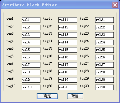

77077 Posted September 17, 2015 Author Posted September 17, 2015 It seems to me you're one step away from gettting back to the standard attribute edit dialog ;-) I can use command "attedit" for attribute edit. My purpose is to learning methods . if more Attribute (>= 20), The Dialog will very long. I hope one column =10 , if attribute >10 , need Add a column ... if necessary, use the "spacer" controls to filling If nobody has the nerve to bug me at my work I will see if I can post my own version of an attribute editor. But it not completely generic and certainly not like anything posted before. Welcome and await. I don't now , can you post word documents here? Because the manual is about 50 pages (and it's writen in ducth) so I have to translate it first to... gr. Rlx what word documents ? Quote

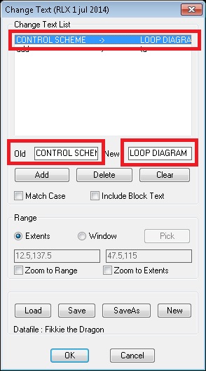

rlx Posted September 17, 2015 Posted September 17, 2015 how about using a list box as I do in my CT routine? Quote

77077 Posted September 17, 2015 Author Posted September 17, 2015 how about using a list box as I do in my CT routine? Thanks rlx. This is another method. I will learning. Quote

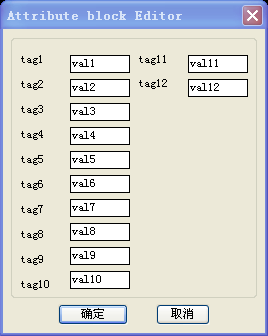

77077 Posted September 18, 2015 Author Posted September 18, 2015 OK! All the problems have been resolved. (setq lst_tag(mapcar 'car lst)) (setq new_lst(LM:groupbynum lst_tag 10)) (setq nt (length new_lst)) (setq lst_val(mapcar 'cdr lst)) (setq new_lst2(LM:groupbynum lst_val 10)) (setq len_txt(+(apply 'max (mapcar 'strlen lst_tag))2)) (setq len_edbox(+(apply 'max (mapcar 'strlen lst_val))2)) (setq fname (vl-filename-mktemp nil nil ".dcl")) (setq fn (open fname "w")) (write-line "EditDCL:dialog{label=\"Attribute block Editor\";" fn) (write-line ":boxed_row { " fn);;2 (setq i 1) (repeat nt (write-line ":column {" fn) (setq v2 (- nt v1) v1(1- v1)) (foreach n (nth v2 new_lst) (write-line (strcat ": text { value=\"" n "\"; width ="(itoa (fix len_txt))"; fixed_width = true;}" ) fn ) ) (if (<(length (nth v2 new_lst))10) (write-line (strcat ":spacer { height ="(itoa(fix(*(- 10(length(nth v2 new_lst)))2)))" ;}") fn ) );end_if (write-line "}" fn) (write-line ":column {" fn);; (foreach n (nth v2 new_lst2) (write-line (strcat ": edit_box {value=\"" n "\"; key=\"key" (itoa i) "\"; width ="(itoa (fix len_edbox))"; fixed_width = true;}" ) fn ) (setq i (1+ i)) ) (if (<(length (nth v2 new_lst))10) (write-line (strcat ":spacer { height ="(itoa(fix(*(- 10(length(nth v2 new_lst)))2)))" ;}") fn ) );end_if (write-line "}" fn) );;end_repeat Test list1 (setq lst '( ("tag1" . "val1") ("tag2" . "val2") ("tag3" . "val3") ("tag4" . "val4") ("tag5" . "val5") ("tag6" . "val6") ("tag7" . "val7") ("tag8" . "val8") ("tag9" . "val9") ("tag10" . "val10") ("tag11" . "val11") ("tag12" . "val12") ("tag13" . "val13") ("tag14" . "val14") ("tag15" . "val15") ("tag16" . "val16") ("tag17" . "val17") ("tag18" . "val18") ("tag19" . "val19") ("tag20" . "val20") ("tag21" . "val21") ("tag22" . "val22") ("tag23" . "val23") ("tag24" . "val24") ("tag25" . "val25") ("tag26" . "val26") ("tag27" . "val27") ("tag28" . "val28") ("tag29" . "val29") ("tag30" . "val30") ) ) Result: Test list2 (setq lst '( ("tag1" . "val1") ("tag2" . "val2") ("tag3" . "val3") ("tag4" . "val4") ("tag5" . "val5") ("tag6" . "val6") ("tag7" . "val7") ("tag8" . "val8") ("tag9" . "val9") ("tag10" . "val10") ("tag11" . "val11") ("tag12" . "val12") ) ) Result: Quote
