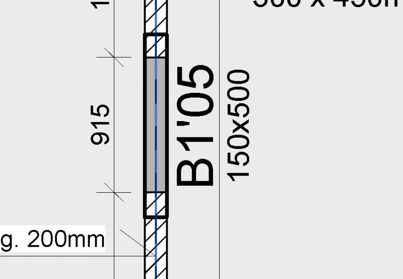

Yeah i noticed that its somewhat infinite the things you can set. Now i think of it, do you know how i could manage this problem (see pic).
The beam is behind the masonry, so we dont see the solid grey fill at the overlap (its a concrete beam above a door, viewed up). We would want to show the grey there....is that possibel by any chance?
Yes, just use an override instead. So, select the Wall and do an Element Override and turn the transparency to 100% to visually "see through" the wall, exposing the beam underneath.
oh sweeeeet, thats it, nice! is it possible to make that setting for all those elements in this view (instead of having them set seperatly like this)?
edit: just managed it, sorry for the quick reply. Again...filters is the way to go =)
Yes, instead of Override Element, select the wall and use the Override Category option instead:
Now, this will change all the walls. If this isn't desired, here's a tip: Select a wall, and type IC to Isolate Category. This will temporarily hide all other Categories. Now, you can Drag+Select, or Pick+Select the wall(s) you want without picking up any other Categories. Make your changes, then type HR to Rest Temporary Hide, and all is back to normal. This tip I use a ton within the Revit modeling environment. Think of it as Layer Isolate. Hope this helps.
