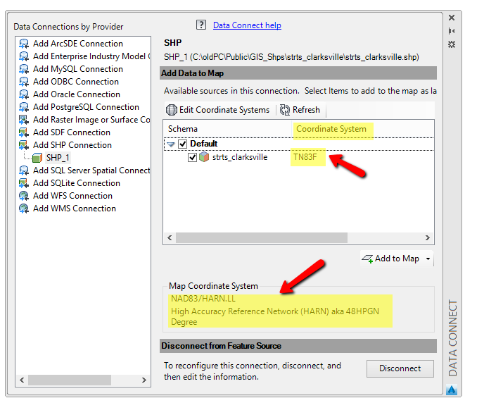

Yes, although I've not been querying the data in. Perhaps this may be my problem? I have the WGS84 field data as SHP files from ArcGIS. I do a data connect in CAD Map to bring the SHP files in (to the drawing using the ED50 CRS), it recognises their CRS but does not give an option to perform a transformation when you add to map and they do not project to the correct location. I've just looked at the 'Add to map with query' option but I cannot see anything on there for transformations. This is an area of CAD that I'm not very knowledgeable in, having done very little with map projections previously. Any guidance in the right direction would be most appreciated.
The query that I mention is when you use the "ADEDRAWINGS" command. If you are using the Data Connect make sure you see both coordinate systems when you connect. See attached.
