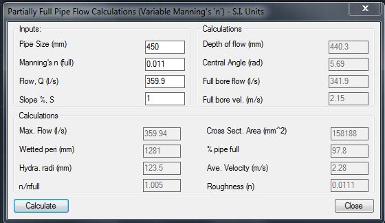

aloy Posted October 16, 2015 Author Posted October 16, 2015 Hi Rlx, Problem solved and it is working well. However I had to recast the dialog as there are to solutions to the calculations when the pipe is more than some 80 odd percent full. Therefore I have revised it to be consistent as shown below. And I give below the dcl for that. I now want to remove the edit boxes appearing below "Max. flow" in "input" box column and also remove the three top edit boxes in the two solution columns. My attempts to do that get me error messages. Could you give an advice please?. aloy2.dclFetching info... Quote

aloy Posted October 29, 2015 Author Posted October 29, 2015 (edited) Hi Rlx, Returned at the beginning of the week. Was busy trying to do the lisp to make the two dialogs stable. That is to prevent someone enter the wrong data end press calculate button. Hope I have succeeded. A typical code snippet is given below. I am sure there may be better and efficient way to do it. Nevertheless it appear to work. The two dialogs for the two versions of solutions are also given below. I tried your slides in post #66. Since the texts in them appear to be not legible decided not to append them to the dialogs. Thanks for all the help. (defun update_flow (val) (cond ((not(and (distof dia) (distof man) (distof slo))) (progn (foreach tile eb_list1 (set_tile tile "-")) (alert "Enter valid values first for 'D', 'S' and 'n'"))) ((and (distof dia) (distof man) (distof slo)) (progn (flowcheck) (set_tile "eb_mflow" q1))) ((equal (distof val) nil) (setq flo "invalid")) ((<= (distof val) 0) (setq flo "invalid")) ((>= (distof val) (distof q1)) (progn (set_tile "eb_flow" "too large") (setq flo "invalid"))) (t (setq flo val)))) (defun update_slope (val) (cond ((equal (distof val) nil) (progn (set_tile "eb_slope" "invalid") (set_tile "eb_mflow" "invalid") (setq slo "invalid"))) ((<= (distof val) 0) (progn (set_tile "eb_slope" "invalid") (setq slo "invalid") (set_tile "eb_mflow" "invalid"))) ((>= (distof val) 5.0) (progn (set_tile "eb_slope" "too large") (setq slo "invalid") (set_tile "eb_mflow" "invalid"))) ((and (distof dia) (distof man)) (progn (flowcheck) (set_tile "eb_mflow" q1))) (t (progn (set_tile "eb_slope" val) (setq slo val))))) (defun Calculate() (if (not(and (distof dia) (distof man) (distof flo) (distof slo))) (progn (foreach tile eb_list1 (set_tile tile "-")) (alert "Value(s) entered inconsistent"))) (if (and (distof dia) (distof man) (distof flo) (distof slo)) (progn(pipe) (flowcheck) (set_tile "eb_mflow" q1) (set_tile "eb_depthofflow" gdx) (set_tile "eb_centralangle" thita1) (set_tile "eb_nn_full" rt) (set_tile "eb_fullboreflow" gq2) (set_tile "eb_fullborevel" gv1) (set_tile "eb_wetted_peri" p1) (set_tile "eb_hydra_rai" ar1) (set_tile "eb_cross_sect" a1) (set_tile "eb_pipe_full" pf) (set_tile "eb_velocity" gv) (set_tile "eb_roughness" n1)))) Edited January 12, 2016 by rkmcswain added [CODE] tags Quote

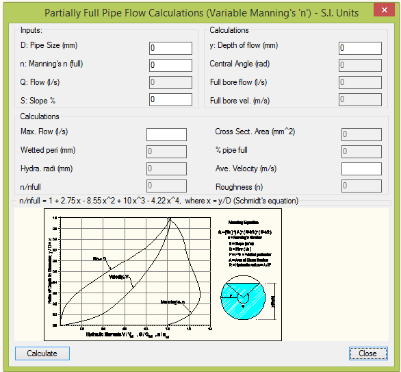

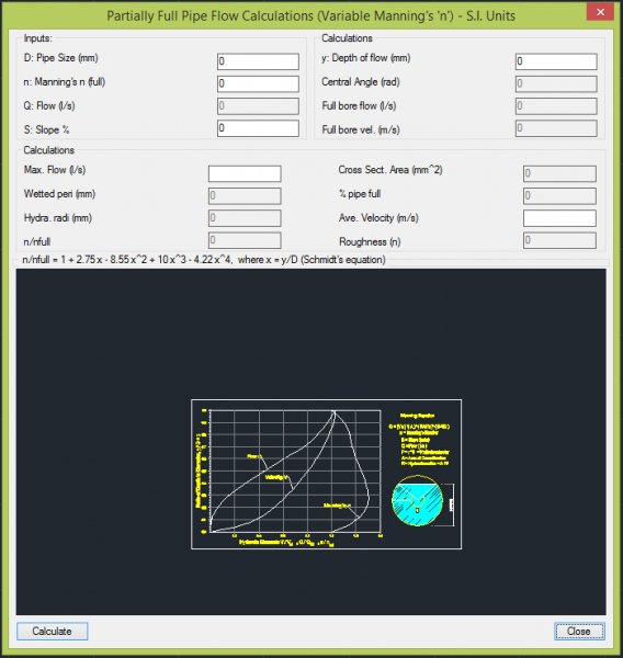

aloy Posted November 4, 2015 Author Posted November 4, 2015 (edited) Hi Rlx, I am back again, Been trying to insert a slide just to explain what all these values in the edit boxes for one of the versions. However I am unable to get the drawing to cover the complete area of the picture. Could you pl help?. I give the dialog and the two files below. It is better to have the BG colour white with the yellow text turned black. Never mind about the initialization of the EBs. aloy (7).lspFetching info... aloy.dclFetching info... variableN.dwgFetching info... Edited November 4, 2015 by aloy Quote

aloy Posted November 5, 2015 Author Posted November 5, 2015 (edited) Rlx, Yes it appears ok, but not large enough to see details. I have got the following by making the height 15 and the aspect ratio 1. The slide was made after zooming extent. I need to increase the picture size so that the text will be legible. Any help?. Thanks for the link Aloy. Edited November 5, 2015 by aloy Quote
rlx Posted November 5, 2015 Posted November 5, 2015 Hi Aloy. Couple of thing you can do. Dont use a fat font for your text's , use something like isocp. Increase your textsize slightly. I dont think a bigger image box would look good. You could maybe split your image in 2 and slightly increase the height of both image boxes in your dialog so the slides would use the available space as optimal as possible. And last option would be to create a second dialog with just one huge image tile on it and assign a zoom action to the image in your main dialog. Then when you click on the image in your main dialog , a second dialog would appear that really shows your slide a big as possible. Maybe I have some time 2nite to cook something up for you but I have 2 little terrorists who want to come sleep over and they can really demand someones complete attention haha. But they have to go to school 2morrow so how bad could it get? (i'll tell you in the morning ;-) gr. Rlx Quote
rlx Posted November 5, 2015 Posted November 5, 2015 Hi Aloy, updated your lsp and dcl file. If you click on the slide you now get a bigger version of the slide. Click on it again and you go back to the main dialog. Note that I changed : image to : image_button gr. Rlx aloy (7).lspFetching info... aloy.DCLFetching info... Quote
aloy Posted November 6, 2015 Author Posted November 6, 2015 Hi Rlx, It doesn't work when I tried. I think you need to define another dialog by the name "zoomslide" as per the code (new_dialog "zoomslide" Dcl_Id%), if I am not mistaken. Isn't the slide imposed on a very large button?. Look at this part of the code: (defun aloy_zoom_slide ( / x y ) (new_dialog "zoomslide" Dcl_Id%) (setq x (dimx_tile "bigslide") y (dimy_tile "bigslide")) (start_image "bigslide") (slide_image 0 0 x y (findfile "variableN.sld")) (end_image) (action_tile "bigslide" "(done_dialog)") (start_dialog) ) Quote
rlx Posted November 6, 2015 Posted November 6, 2015 (edited) Hi Aloy , it works fine with me. If you look at the dcl file in the previous post (#97) I have added the "zoomslide" dialog definition so maybe you use the incorrect version? Try (findfile "aloy.dcl") and see if the path and filename returned are the correct one. One more post and we can celebrate the 100th post :-) btw , when you get it working , you see what I mean about not using fat fonts. Use a single line font. gr. Rlx Edited November 6, 2015 by rlx Quote
