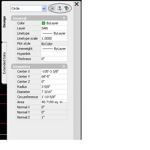

JONTHEPOPE Posted December 23, 2008 Share Posted December 23, 2008 Could some one explain how / when i should use buttons circled in attachment . in school i remember them being really good for something but cant remember what ? (selection set i think??) Quote Link to comment Share on other sites More sharing options...
MaxwellEdison Posted December 23, 2008 Share Posted December 23, 2008 They're different ways to select objects to control their properties, hover over them and read the tooltip. They are, from left to right, PICKADD (toggles the system variable), Select objects (like selecting them for a command but just shows properties), and Quick select (QSELECT from the command line, basically a selection filter) Quote Link to comment Share on other sites More sharing options...
