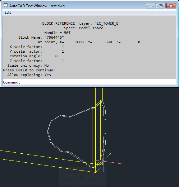

Now i came so far that i am able to change the entity colors but how can i find out the entity main block name while using nentsel?

Try
(vl-load-com)
(defun c:demo (/ nsel l ll)
   (if (and (princ "\nSelect a block entity: ")
            (setq nsel (nentsel))
            (setq l (last nsel))
            (setq ll (last l))
            (= (type ll) 'ENAME)
           (setq obj  (vlax-ename->vla-object ll)
                 name (vla-get-effectivename obj)
           (princ (strcat "\nThe block name is: " name))
       (princ "\nThe selected object was not from a block...")
I hope this helps.
Henrique
