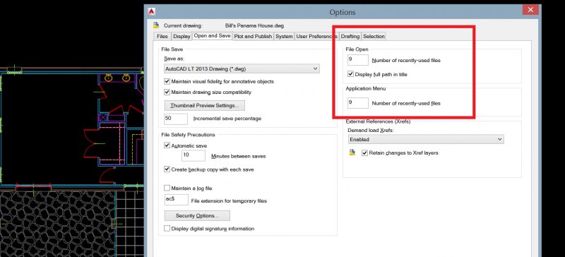

Dana W Posted August 29, 2015 Share Posted August 29, 2015 Are you talking about the "Recent Drawings" that come up on your newly opened AutoCad window? Like right here in the red box? Quote Link to comment Share on other sites More sharing options...
rebuilding Posted September 1, 2015 Author Share Posted September 1, 2015 Hi Dana, no not that list, the list that you get when you press the 'open file' tab on the menu bar. Then when you tap one of the files on the list you get a thumb nail picture of that drg. to the right. Quote Link to comment Share on other sites More sharing options...

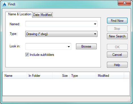

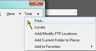

rkmcswain Posted September 1, 2015 Share Posted September 1, 2015 You can also click Tools > Find in the upper right corner of the Open dialog to Search for drawings by name and/or date modified. Quote Link to comment Share on other sites More sharing options...
