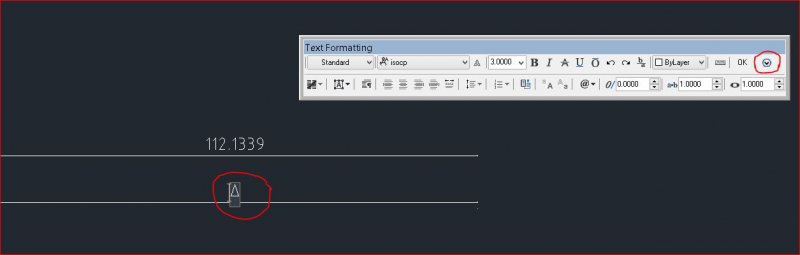

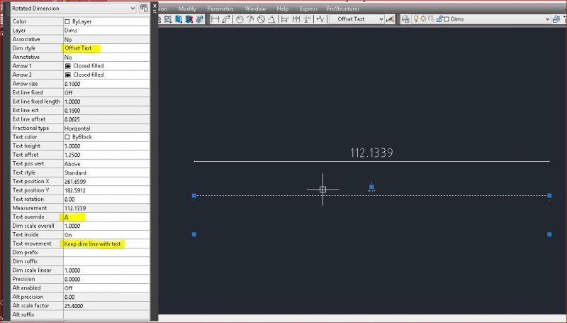

Dadgad Posted August 28, 2015 Posted August 28, 2015 (edited) If the built in placement justification settings aren't enough for you when working in a table, and you need to have Offset functionality, you dould define a DIMSTYLE. In which you would, on the LINES tab, choose to SUPPRESS both EXTENSION LINES. On the TEXT tab you can specify the font, color and offset from the Dimension Line. Once you have it set up, give it a name that makes sense, and SAVE it. If you want to use it, select it and SET CURRENT. If you double click on the dimension text, you can override it, with whatever you want, including with a DELTA icon which is available in the mtext editor. I will post an image momentarily. If you open the drop down menu on the right end of the mtext editor, then choose SYMBOL, you will have found the holy grail. Edited August 29, 2015 by Dadgad Quote
