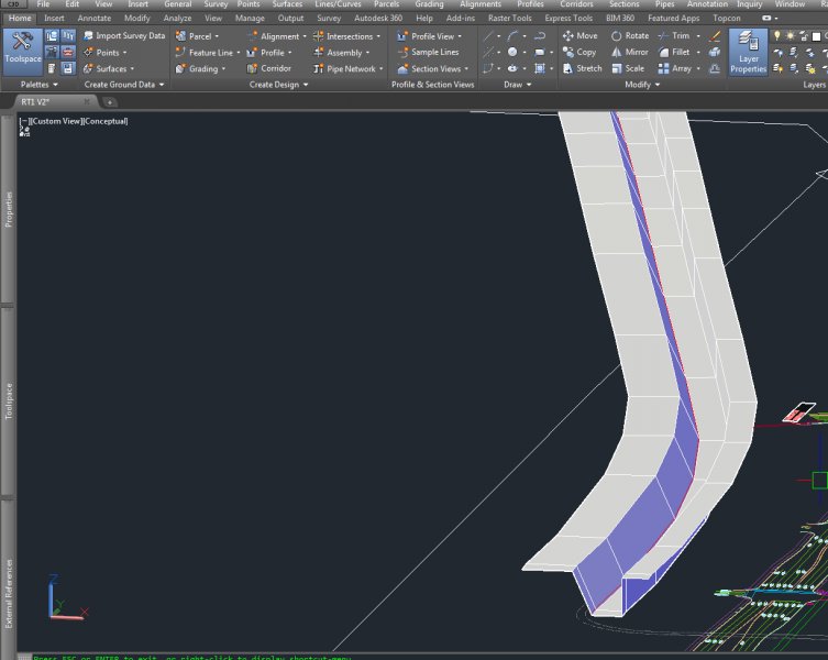

Good day sons of tron, I am needing assistance in the matrix to help our team win the LRT bid. Our engineering did not provide prop road and track surfaces so i have to develop something quick based on a variety of cross sections. I am an experienced CAD operator but i am still learning C3D.
I have:
existing contours
prop alignment with 3d polyline
prop pdf cross sections
I was thinking the fastest way is to somehow use a sweep surface in C3D from quick poly-line cross sections and convert to a surface to compare from but i am not able to add the sweep surface to a surface, I thought that create sub assembly from a poly-line would work this way, but I could not get it too work.
Sons of tron, can you assist your brother-en.

hello, what is the best way to do a cut fill volume for LRT and Prop road.
I have:
Prop Alignment with 3d polyline
Existing ground
PDF cross sections
I tried:
Sub assembly from 2d polyline
Convert sweep surface into a surface
