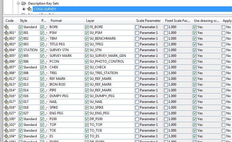

BIGAL Posted August 27, 2015 Posted August 27, 2015 Kelsvcc92 you need a DWT that matches the area you are in, simplest is metric or Feet, all of the librrary functions are critical for the automatic generation of line work, whats contourable, breaklines etc. Where are you in the world, ask nicely and someone may have a DWT that you can use. Your file is ok but you need a library to match the descriptions. Quote
