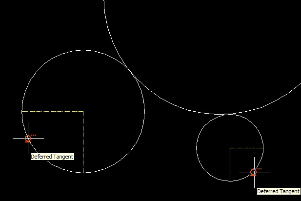

I need help on "bean" part. How to draw the lower arc in "bean" part? When I tried to draw it with TTR, the arc is formed in opposite direction:
When you choose the circles using TTR make sure you choose in the quadrant you want the tangent point:
Thanks a lot, man. It worked. :D
