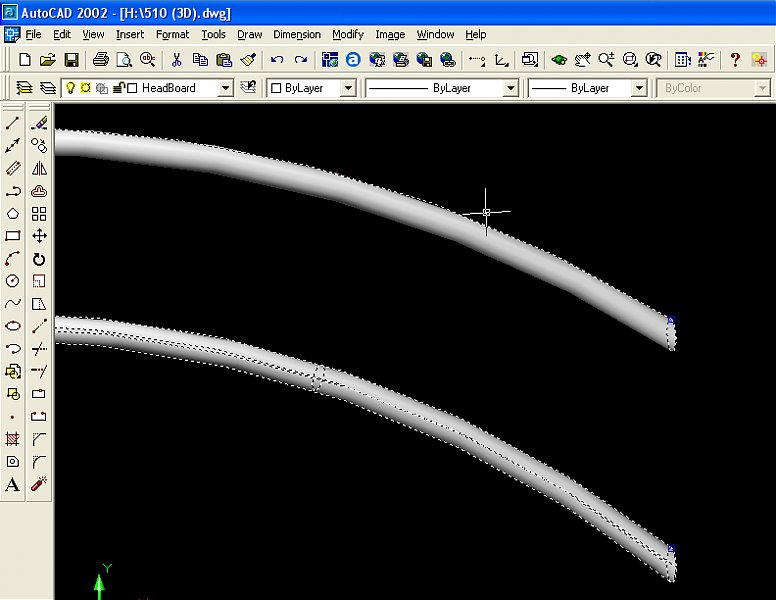

How did this happen?
marlon
Compare the 'hidden lines' (sorry if that's not the correct term) of both objects. The upper object has only one line.
This is in 2D Wireframe.
If I print it, the upper drawing would be a line only, and I cant have that.
I thought regen would fix it but it didn't.
Should I just draw another one?

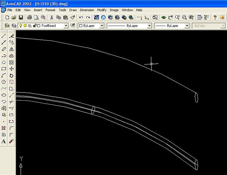

[ATTACH]9063[/ATTACH]
[ATTACH]9064[/ATTACH]

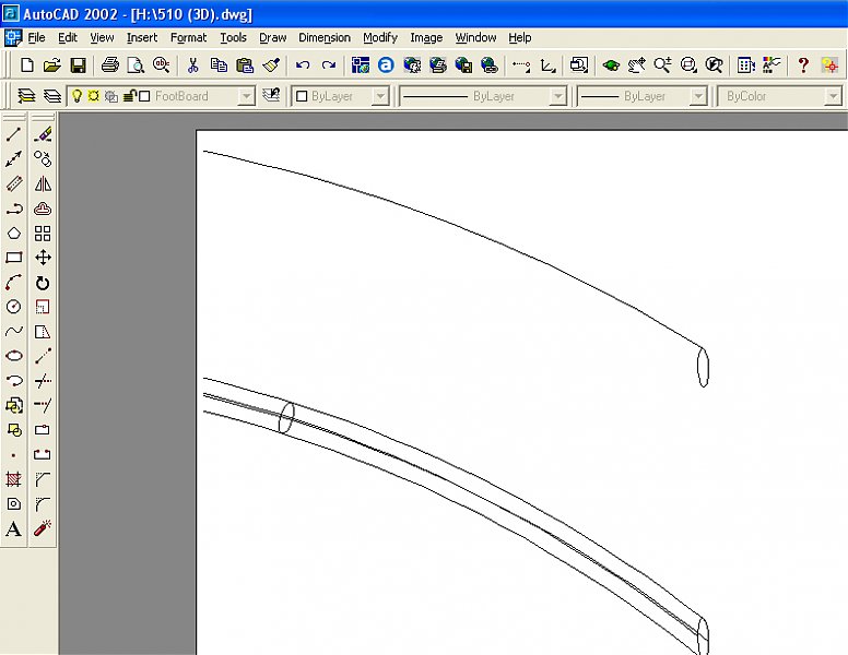

[ATTACH]9065[/ATTACH]

ok big bro....
im not really sure... but i think command isolines might work..
in the command line type isolines
then type 15.
then try to regen...:)
i guess the upper figure is a solid object. the lower object is the exploded object of the upper one...:?
how were they drawn. i would guess you used extrude>path?
is one a copy of the other?
select one of them, right click, then go to properties and see what it says at the top of the properties box. should say line, or solid, or surface etc.

Shift1313:I don't think one is a copy of the other. Yes I used extrude>path
They are both solids.

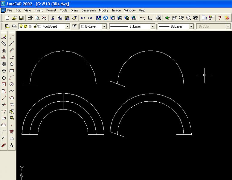

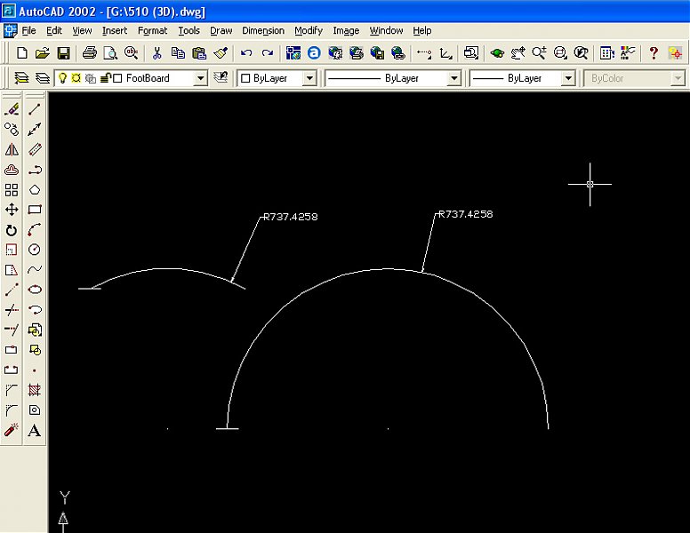

Here's a little experiment I did, tell me what you think.
Notice that both objects have the same radius. The left one is just a small arc, then I copied it to the right and used EXTEND to make it a perfect half circle. (the small lines at the end of the arcs are NOT lines but circles which are to be extruded along the arcs)

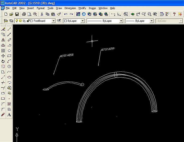

Now here's what they look like extruded. Notice the small arc has only one isoline (not counting the arc path) but the half circle has the standard 4 isolines (not counting the arc path).
I'm left with the conclusion that arcs less than half a circle would have only 1 isoline when extruded. Am I wrong?
The object to be extruded should be perpendicular to the path, such as the one on the left. I copied it to the right, rotated the object to be extruded, extruded it, and the result is only one isoline (excluding the arc path).
Can anyone confirm this?
does the same thing for me if the path and sketch arent tangent. im not sure if it has to do with some display settings or not but my images are the same as yours(and have always been). ill play around with it a bit when i get the chance.
