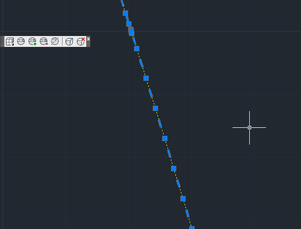

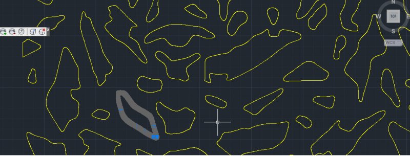

sati464 Posted August 15, 2015 Posted August 15, 2015 Hi sir, Please find the attached picture. We are having a project for waterjet cutting of aluminium plate profile is as shown. This drawing is supplied by customer. while selecting, the profile showing multiple points. how to convert this into single line. Our Waterjet cutting software is not reading this drawing and showing error. Please help me Quote

Dana W Posted August 15, 2015 Posted August 15, 2015 Those objects are not made up of splines, they are polylines. Quote
Cad64 Posted August 15, 2015 Posted August 15, 2015 I got an email this morning regarding this issue. Not sure why he posted here and then felt he needed to email me as well? Anyway, he didn't mention whether they were splines or polylines, which is kind of important, but I assumed they were polylines and pointed him to the lisp routines below. PLDIET: http://cadtips.cadalyst.com/linear-objects/polyline-diet WEED2: http://cadtips.cadalyst.com/linear-objects/weed-r13-polylines?print=1 If they are splines, they can be converted to polylines with the routine below. SPLINE-TO-PLINE: http://cadtips.cadalyst.com/curved-objects/splines-plines Quote

Cad64 Posted August 16, 2015 Posted August 16, 2015 Please give me detail steps how to run the command It's pretty self explanatory. Just watch your command prompt. Run the command Enter the maximum distance between points - (I entered 2.0) Enter the maximum change in direction to straighten - (I entered 2) Choose to Straighten or Retain arc segments - (I chose to retain arc segments) Select a polyline and then hit Enter That's pretty much it. Quote
sati464 Posted August 16, 2015 Author Posted August 16, 2015 Hi sir, Thanks for your reply still it is showing points Quote
Cad64 Posted August 16, 2015 Posted August 16, 2015 Yes, of course it's showing points. Points are what defines the shape of a polyline. The purpose of the PLDIET routine is to eliminate a lot of the excessive points, not get rid of all the points. What is it you're expecting? Quote
