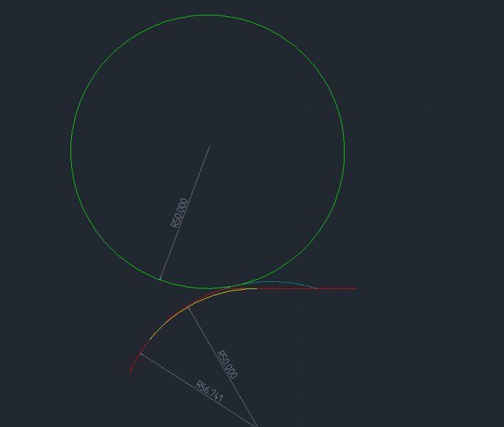

i have an drawing issue that is recurring in almost every drawing i make.
Sometimes i go from an ARC (R=200) to an straight line and the ARC overshoots the STRAIGHT line, so i want to make an extra curve to make a smooth transition.
So then i use FILLIT to make an ARC R=50 between the R=200 and straight line.
Usually this works fine, and if not it probable will work with 'tan tan radius' (Circle > T).

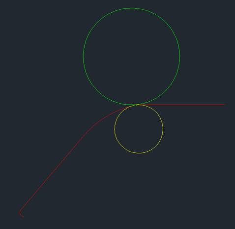

However sometimes fillit doesn't work and then i use TAN TAN RADIUS and start with a small radius to see the margin. Then when i try to use an bigger radius, that should work, the circle ends up on the outside of de R=200 and the straight line.
When i copy the lines to a new drawing it seems to work just fine, but in the original drawing it messes things up.
Example in the image below
Red line is R=200 and the horizontal line is the straight part. The yellow circle is R=50 and the green is R=100. It should work (in a new drawing) but not in this image.
Why?
Can you attach a drawing of the 2 lines and the 200' arc. In the image the lines appear tangent not sure how "the ARC overshoots the STRAIGHT line". Fillet should work, do you need the circles drawn as well? Just not sure what you're trying to do.
Maybe this helps:
The yellow arc is made by FILLIT and the green circle is made with TAN TAN RADIUS (Circle > T)
Both have an radius of R=50 but the circle ends on the outside of the line.
The overshooting part is the dotted blue line.
An example is easily made self.
I'd skip using the Arc command and just fillet the two lines specifying the desired radius.
Well duh :P
But why does it do this? It should work right in both ways, but it doesn't...
Maybe this helps:
[ATTACH=CONFIG]55224[/ATTACH]
The "dotted blue line" appears to be an extension of the 200' radius. It should veer away from the 50' radius arc. Still don't understand what the problem is.
Well duh :P
I suppose that would be determined by what version of the Arc command you are using and how you are specifying the points AutoCAD is asking for.
Give us a before and after drawing showing what you started with and what you want to end up with and we can show you several simple ways to do it. Should be easy with either arc or fillet, though fillet is usually less steps.
