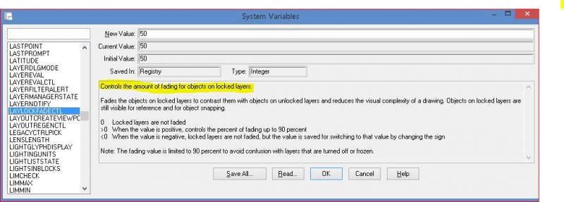

Is there a really quick way to turn off ALL Layers except for specific selected items (no matter what layers they are on)?
Sometimes I really need to quickly view/edit specific items or just one item but need some other specific items to still show for reference etc. and need to get rid of all else for a while.
Is there a lisp or command available for doing this?
Cheers.
Are you familiar with the LAYISO command?
Very helpful, coupled with LAYUNISO to restore all layers to unisolated.

Indeed I am.
However this does not function as per my posting, as it leaves the items - although Isolated - still visible.
I need the items to be "invisible" (as in Layer OFF), to make it easier and much clearer to work only on the specific items i require only.
Cheers.
Look at the edit to my previous post, you can change that behaviour with the commandline settings prompt, and once you change it, it will be remembered.

Good function, however even with the highest fade it is still too crowded with multiple wireframes objects in the way...

If you select OFF in the commandline settings, what happens?
As shown in my commandline screenshot earlier?
The screenshot was not meant to constitute an endorsement of the default option.
Nice One! :D
Exactly what I wanted....and I can now see the specific objects clearly.
Perfect and thank you very much!
Glad I could help you. :beer:
