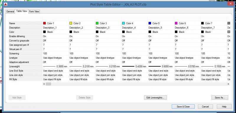

Half the office has recently updated to ACAD 2015 the rest are still using ACAD 2010. When we print with the office standard CTB file in ACAD 2015 some of the lines plot thicker at random (i have attached a PDF as an example, i have also attached a screen shot of the CTB plot style table editor). Plotting from ACAD 2010 works perfect. The printer we use is a Toshiba estudio 4555c if that helps. It is color 6 that is the issue and sometimes color 8.
Any help would be greatly appreciated.
Cheers, have a good day

The images are too small to give a good look but I think I see other differences. I would check the printer settings carefully for any differences.

Yeah, the PC3 file contains the printer settings for AutoCAD. I would shy away from using the old file. Just match the settings.
Our CTB are on the server so only 1 is there 2, 2010 & 2015 versions
Hi all sorry for taking so long.
The CTB and PC3 files are on the server (use the same one for 2010 and 2015).
