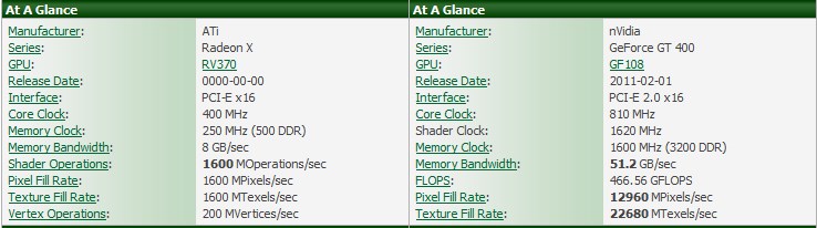

I concur with SLW on the graphics card. Your card, ATI X550 has a memory bandwidth of 8 GB/sec. My old nvidia GT440 on my home PC has a bandwidth of 51.2 GB/sec. You have an old, slow card.
I also agree that it's time to get a new PC. You can get a descent one for a good price. I will offer this one bit of advice, stay away from ATI video cards. They have descent hardware but their drivers are horrible. Just stick with nVidia.
