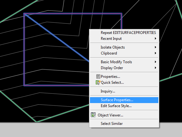

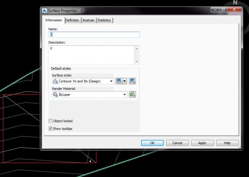

Right Click on your surface and go to Surface Properties.
Under the information Tab go to Surface Style and switch it to a different Style.
I went ahead and made the change. See your attached drawing.
