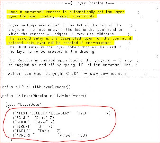

Here is a video how LM:layerdirector can be used to assign default layer to 3D operations like extrude, sweep, loft, sections, etc.
'solid' Will not work that way i think..
  halam said:
'solid' Will not work that way i think..������
Works fine, I just checked it.
One of the many things I love about this lisp, is that it creates the layers you have designated, if they don't already exist in the drawing, then returns you to whatever layer was current, before you called the reactive command. Inspired Lee! :beer:

I sure would like to thank Lee Mac for updating the code.
;; Version 1.4 - 2016-01-10
;; - Added the ability to cue a layer change following the use of a
;; custom AutoLISP command.
;; - Added Plot Style property to Layer Data list.
About the ability i was hoping that this means my custom commands can be used to follow in Layerdirector. I did not experiment with it yet but maybe the code beneith should work. This code is a need-to-use.. :)
http://www.lee-mac.com/layerdirector.html
(defun LM:layerdirector:lispcommand ( str )
(if (wcmatch str "(C:*)") (substr str 4 (- (strlen str) 4)) str)

About version 1.4 and the ability to call custom routines.
Somehow not yet all my commands are issued at the right time.
The layerdirector should have done its works BEFORE custom commands are carried out.
It seems to me this is not allways the case.
I think if have to do some tricks or do my programming better.
Thanks for you're help anyway. :)
