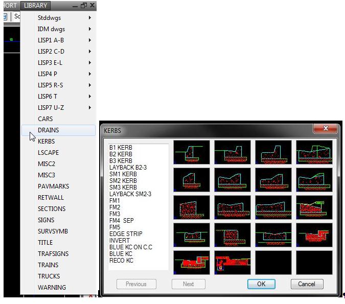

BIGAL Posted July 24, 2015 Posted July 24, 2015 I used old fashioned slide method and menus. Obviously the tool palette took over but pretty picks. If you can use Notepad you can make a menu. Quote

tombu Posted July 24, 2015 Posted July 24, 2015 I used old fashioned slide method and menus. Obviously the tool palette took over but pretty picks. If you can use Notepad you can make a menu. I created a few Image Tile menus years ago, gave an online course back in 2003. The macros import and place blocks how you want even , no need to have them all in each template since the images were in a library file. Tool Palettes are easier to learn to create, but not necessarily an improvement. Wish I'd kept some of those old menus sometimes. One more option would be to use Lee Mac's Steal lisp http://www.lee-mac.com/steal.html This macro for example will import this list of blocks "Block1 Block2" from C:\\My Folder\\Master.dwg: ^C^C^P(or Steal (load "StealV1-8.lsp"))(Steal "C:\\My Folder\\Master.dwg" '(("Blocks"("Block1" "Block2")))) Quote
