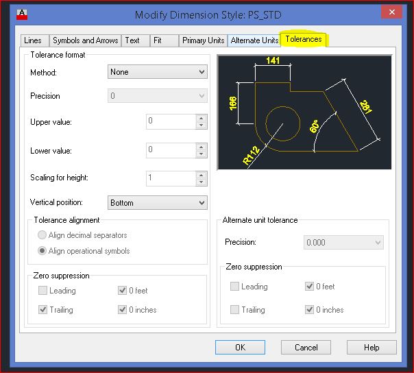

Because the Tolerance is defined on the Tolerance Tab when defining a Dimension Style.
If you change a given dimension from one style to another dimension style, it will assume all of the properties defined in the newly assigned dimension style.
If you look at the screenshot, you will see that in a default Autcad dimension style (although the screenshot is from Autocad with the ProSteel add in) there are no defined Tolerance Values.
Unless the dimension style to which you wish to change already includes Tolerance definitions on the Tolerance tab, none will be shown, regardless of whether or not they were in the original dimension style, which you are changing.
In order to display the Tolerances, as in the other dimension style, upon changing the dimstyle, you will need to define the Tolerance settings in the new dimstyle first.

Thanks for your reply .Dadgad
That's mean , Cant' change dim-style ?
Different dim, tolerance certainly not the same.
The new Dim Style will need to have Tolerances set up.

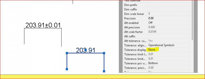

Another way to affect the Tolerance display, selectively, would be by using your Properties, or Quick Properties (as shown with QPs) in the screenshot.
The left hand dimension was copied, they are both the same dimension style, but on the right dimension I have turned off the TOLERANCE display, as highlighted in yellow in my quick properties palette.
