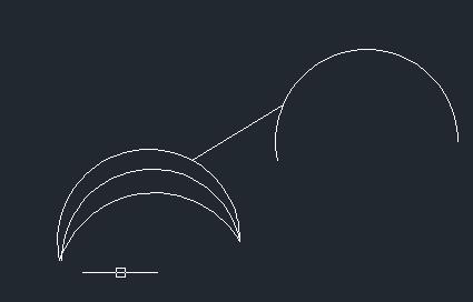

I'm looking for a way to draw an arc by using this order of points:
1. START
2. END
3. MIDDLE (middle of the arc, aka bulge)
The drawing A is the arc I'm looking for, but this was done by using arc command and selecting 1,3,2 points
when selecting 1,2,3 points it produces arc  C
Drawing B is "Start, End, Radius" type, which draws correct geometry arc, but on opposite side.
None of the commands produce the desired result:
3-points circle drawn exactly what I'm looking for the arc.
Any ideas? Thank you.

What I meant was the preview of the arc is "attached" to the cursor, unlike to an arbitrary line as in
(command "_arc" pause "_e" pause "_d")
What I'm looking for is similar to Lee Mac 3-point circle
So I guess "center" wasn't a proper word for it, perhaps bulge is more appropriate?

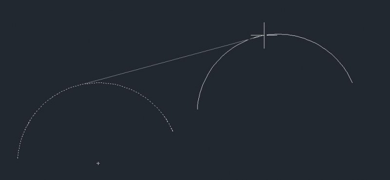

Using a program you can do dynamic stuff like dragging a circle, I think you need to post an exact image of what it is you want it does not matter if you draw multiple arcs.
Ok, draw an arc, now click on it and grab the middle grip, start dragging it around - that is exactly what I'm looking for during the initial creation of an arc after start and end points are set.
Hopefully this is clear now
Why can you not do that now using MID and MOVE I think we are still missing something. I used copy for the image the line implies the copy direction but its still out of the box methods. Its a case of putting together a lisp that makes the arc and then uses the mid point as snap point can be done is this what your trying to do just remove the couple of manual steps. Please let us know.
No, I'm not trying move the entire arc. In my last example clicking on the arc is necessary to bring up the grips, the grip in the middle you'd use to drag around to change shape of the arc.
So, yes, creating a temporary arc after user submitted start and end points and then use stretch on the middle of the arc for the third point would work, except my lisp knowledge is limited to achieve that, that's why I asked if such solution already available...
Standard ARC response Start Pt End Just pick 3 points in order ?
Hmmm it seems Lee Mac's 3-point-arc visually does what I'm looking for, with just slight modification - switching p2 with p3:
