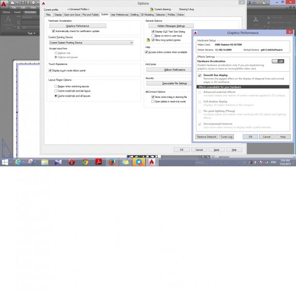

Without updating, I figured out that my graphic card is up-to-date. I check the date and version og mine with the one in Lenovo site.
Therefore I didn't download it.
Any other comment is very welcomed.
Is hardware acceleration enabled?
What other programs are running in the background?
Thanks for your continuous support.
Following site says:
http://answers.microsoft.com/en-us/windows/forum/windows_8-hardware/how-to-increase-hardware-acceleration-in-windows-8/10aa6528-85ba-468d-bdcb-3afea0535a52?auth=1
In the Advanced Settings window, if Troubleshooting tab is present, then the graphics card supports hardware acceleration.
I don't have this tab. so my com don't support HA
I'm not sure if AutoCAD will recognize that a GPU doesn't support hardware acceleration. ReMark was referring to the setting in AutoCAD. If your GPU does not support it, you may need to turn it off as I think it is on by default.
Dear Rob and ReMark
Thanks for both your input I was able to resolve the issue.
I didn't know that Remark is referring to turning off HA in AutoCAD. I thought it is related to OS
After reading Rob's post, I went to Tools/Option, system tab and first option is Hardware Acceleration.
I turned it off and it solved my problem.
Although I didn't figure out what caused the problem and what is its relation to HA, but I am happy that problem has gone away.
Thanks for both of you.
By default the HA was on and I turattachment.php?attachmentid=54896&cid=1&stc=1ned it off
