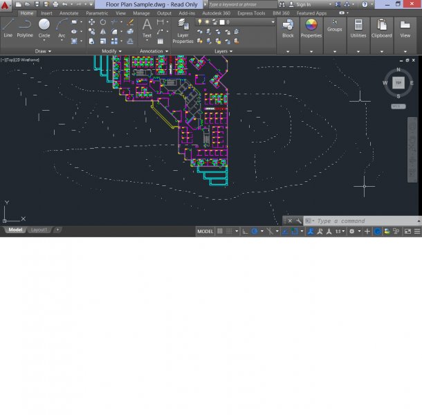

khoshravan Posted July 16, 2015 Share Posted July 16, 2015 In Autocad 2015 when I move cursor around, a path tracing cursor remains in the monitor which is annoying. Is there anyway to turn off this capability? Quote Link to comment Share on other sites More sharing options...

khoshravan Posted July 17, 2015 Author Share Posted July 17, 2015 This is what I am talking about. Quote Link to comment Share on other sites More sharing options...

ReMark Posted July 17, 2015 Share Posted July 17, 2015 What you show in the images has nothing to do with tracking vectors. I think you have a display problem. Quote Link to comment Share on other sites More sharing options...
RobDraw Posted July 17, 2015 Share Posted July 17, 2015 Those are not tracking vectors. That is a graphics problem with your computer. ...or it's what ReMark said. Quote Link to comment Share on other sites More sharing options...
Dana W Posted July 17, 2015 Share Posted July 17, 2015 Yup, no tracking vectors are doing that. We'll leave the vectors for after you get this problem solved. You won't be able to see them anyway. This is definately a video card or video driver, or even a mechanical issue with the monitor screen. Quote Link to comment Share on other sites More sharing options...
khoshravan Posted July 17, 2015 Author Share Posted July 17, 2015 What you show in the images has nothing to do with tracking vectors. I think you have a display problem. Display Problem Glad to find the proper word to describe my problem. What should I check to find out what is the cause of this problem. Later I have to find a solution to fix this problem. Quote Link to comment Share on other sites More sharing options...

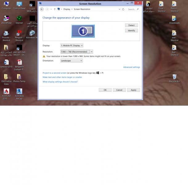

khoshravan Posted July 17, 2015 Author Share Posted July 17, 2015 I thought changing screen resolution might solve the problem. This is the screen shot for resolution. It says:Your resolution is lower than 1280x960. But inside the box the maximum value to choose is 1366x768 and it is chosen. How can I change this setting? Quote Link to comment Share on other sites More sharing options...
RobDraw Posted July 17, 2015 Share Posted July 17, 2015 Try updating the driver. If that doesn't solve the problem, a harware upgrade would be in order. Quote Link to comment Share on other sites More sharing options...
