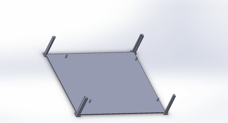

I have been trying to make threads which I need for my project but I am doing something wrong:cry:,so if anyone is willing to help with making threads on those 4 bolts and nut for it I would be grateful:)

Could you use the simplified or cosmetic thread options from the nuts and bolts in the toolbox? If you made the nuts and bolts yourself, you could apply a cosmetic thread to them if it's just for a visual. Adding a helical thread on those parts is only going to add unnecessary data to your file unless you absolutely need them.
