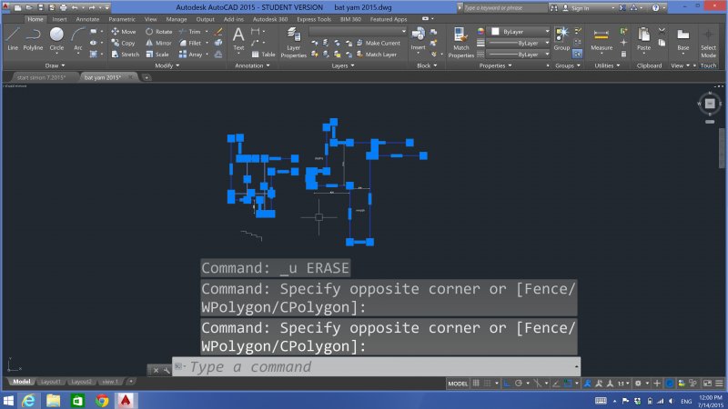

I am quite new to AutoCAD, I have 2015 version and a 4K res screen (don't know if it is related...)
The font of the commands I press appears very big
how can I make it smaller?
I attached a print screen photo as an example
Hi and welcome to the forum!
Go to Options (right-click on the commandline and choose Options or type OPTIONS) and on the Display-tab, click the Fonts-button and change the Size of your text.

Except for the command line text, everything else in your screen shot looks normal. If you made a big jump in resolution when you upgraded, the smallness is probably due to that and totally normal. If you are unable to adjust, you may want to decrease the resolution on your monitor. (It hurt typing that.)
