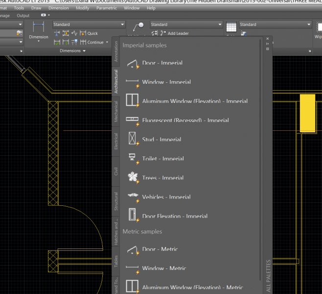

By the way, AutoCad has door and window blocks that come with it, in the tool pallets, click TOOLS >> Pallets >> Architectural tab. See the second image.
I do have the door and window schedule. What I did so far is I figured out how to do the windows with the horizontal line. For the doors I have only cut out the locations of the doors using the schedule. I wasn't sure if I had to have the curve of the door at a particular angle, etc. Also, the outside doors look different. I believe there are some sliding doors as well.
