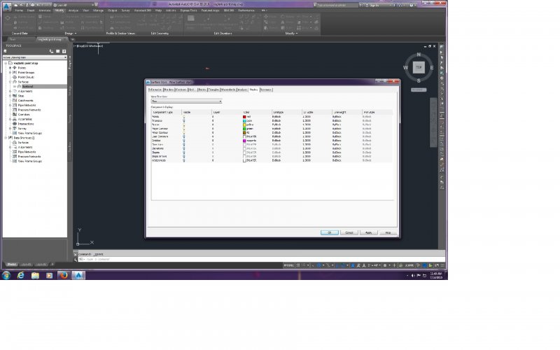

JediCADgirl Posted July 14, 2015 Author Posted July 14, 2015 (edited) I added all the point groups and I still don't see contours. Not sure what I'm doing wrong. I also changed the styles to 20' and 100' (Background). Edited July 14, 2015 by JediCADgirl Quote

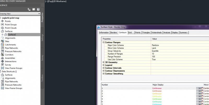

tombu Posted July 14, 2015 Posted July 14, 2015 I added all the point groups and I still don't see contours. Not sure what I'm doing wrong. I also changed the styles to 20' and 100' (Background). Looks like you added another Point Group "Point Group - (1), just delete that. On the Prospector tab of Toolspace expand Surfaces → Surface2 → Definition and right-click Point Groups then click Add… select _All Points, Apply, then OK. Right-click Surface2 & select SurfaceProperties… then set Surface style: to "Contours 5' and 25' (Background)". In Surface Properties to the right of the Surface style: pick the ▼ down arrow then "Copy Current Selection". Copy your Contours 5' and 25' (Background) and rename it Contours 50' and 250' (Background). After renaming the Surface Style select Contours tab, then the + by Contour Intervals, change the Minor Interval to 20 and hit enter, Apply, and OK. Make sure the Surface style: is set to "Contours 50' and 250' (Background)" in Surface Properties and click Apply, then OK. That should do it. Quote
tombu Posted July 14, 2015 Posted July 14, 2015 I see now you added the Surface Style "New Surface Style" and set the intervals. All you need to do is edit that Surface Style, go to the Display tab and turn the Visible on for Major Contour & Minor Contour and click Apply, then OK. That should do it. Quote
JediCADgirl Posted July 14, 2015 Author Posted July 14, 2015 Did it. Still can't see anything on my screen. Ohhyyy!!! Quote
JediCADgirl Posted July 14, 2015 Author Posted July 14, 2015 (edited) here's what i have now. Edited July 14, 2015 by JediCADgirl Quote
