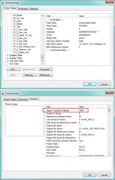

edoll Posted June 29, 2015 Share Posted June 29, 2015 Hello, I should first note that I am aware of this thread which gives great instructions on how to import a dgn file into AutoCAD: http://www.cadtutor.net/forum/showthread.php?35543-DGN-files-in-AutoCAD I follow the instructions as follows: 1. Enter IMPORT at the command line. Ensure that Micro Station DGN (*.dgn) is selected from the drop down list of ‘Files of type’.Select the .dgn file you wish to convert. 2. In the box that appears: Ensure ‘Model’ is selected from the ‘design model from the DGN file’ Ensure ‘Translate references to DWG xrefs’ is selected. Ensure ‘Master units’ is selected. Ensure ‘Explode text nodes to text elements’ is selected. Select OK. 3. This will open a new drawing. In the new drawing, click Format ØPoint Style. Ensure the . (top left hand box) is selected. Click OK. 4. Save / print / view, as you would normally. I do all of this and I do not have any linework showing up - all of the layers are listed. I do not understand a few things though and maybe this is the issue. Under Step #2 above it says "Ensure ‘Model’ is selected from the ‘design model from the DGN file’" - But I do not have "Model" as an option I only have "Design". Also in step 3 I have no clue what that means but I did research and find that ddptype brings up a dialog box which is similar and I make sure that is clicked. Any idea why i cannot see the linework? I would Attach the .dgn file, but it is 637 kb and I guess the limit is 500kb lol of course this would happen. Please help me figure this one out, im dying here! Quote Link to comment Share on other sites More sharing options...

rkmcswain Posted June 29, 2015 Share Posted June 29, 2015 (edited) It contains 3086 entities, 10 textstyles, 3 linetypes, 92 levels (layers), 2 dimension styles and 4 blocks. I suppose the entity count could be including non-graphical entities, such as dictionaries and regapps.... But DBLIST reports nothing in the graphical part of the drawing. Edited June 29, 2015 by rkmcswain add url Quote Link to comment Share on other sites More sharing options...
