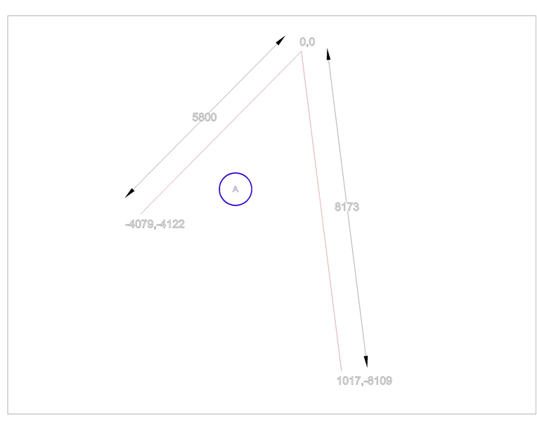

I'm trying to write a function in VBA that calculates the shortest continuous line that bisects 2 lines and a circle between them. I can calculate the line lengths and the included angle in VBA but can't figure out the other bit.

You can use the intersectwith in VBA draw a line at an angel and slowly iterate it with a small angle till you get a answer
'an example you will need to do twice two lines and a temporary line
Set arcobj = Thisspace.AddArc(vertPt, cRad, endang, startang)
retval2 = arcobj.IntersectWith(oPoly, acExtendOtherEntity)
