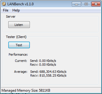

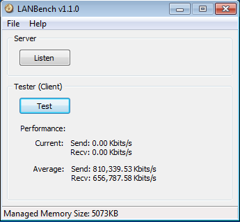

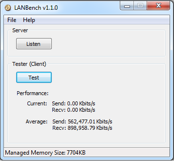

pixel8er Posted August 5, 2015 Author Posted August 5, 2015 I've noticed in the past that a lot of network slow downs can also be attributed to how users log on to the server. I'm assuming your on a windows server? Yes it's a windows server. The fibre is gigabit - refer attached image. I did some testing of the upload/download speeds between computers on the network - refer attached images. Quote
