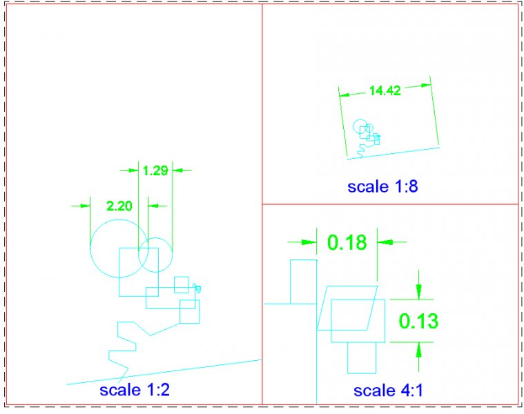

Dschechter Posted June 24, 2015 Posted June 24, 2015 (edited) Trying to practice annotative scaling in viewports, but dimensions in the lower right viewport are larger text than they should be. Is something compounded to make it larger? All are using same annotative dimension style. I feel like it's something obvious thank you! [ATTACH]54698[/ATTACH] 2010 v. annotative practice.dwgFetching info... annotative practice 2010.dwgFetching info... Edited June 24, 2015 by Dschechter Quote

ReMark Posted June 24, 2015 Posted June 24, 2015 File size has no bearing on annotative scaling whether we are talking about blocks, hatches, text or dimensions. I think you may have failed to assign the proper annotation scale(s) to the dimension(s) in question. Have you checked? Have you also checked the scale assigned to the viewport and is the viewport display locked? BTW...we don't need the entire drawing. Just enough to demonstrate the problem is all that is required. Quote

Dschechter Posted June 25, 2015 Author Posted June 25, 2015 ReMark said: File size has no bearing on annotative scaling whether we are talking about blocks, hatches, text or dimensions. I think you may have failed to assign the proper annotation scale(s) to the dimension(s) in question. Have you checked? Have you also checked the scale assigned to the viewport and is the viewport display locked? BTW...we don't need the entire drawing. Just enough to demonstrate the problem is all that is required. I checked what you mentioned, it looks right to me. The viewport in question is focused on that little cluster that can be seen in the left viewport Quote

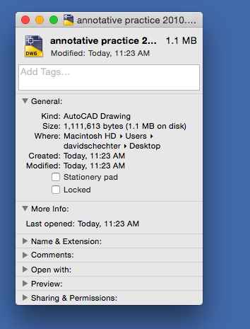

Dschechter Posted June 25, 2015 Author Posted June 25, 2015 I agree with you, but for some reason it saves as 1.1 Mb? I simply saved as AutoCAD 2010. Quote

RobDraw Posted June 26, 2015 Posted June 26, 2015 Your view settings are not right. Change them to 2D wire frame from realistic and you should be able to get what you are looking for. Quote
Commandobill Posted June 26, 2015 Posted June 26, 2015 I brought your drawing into a new template and it worked perfectly... I wish I could give you a good explanation of why it didn't work, but I can't. Quote
Commandobill Posted June 26, 2015 Posted June 26, 2015 RobDraw said: Your view settings are not right. Change them to 2D wire frame from realistic and you should be able to get what you are looking for. Didn't read this before I posted. ^^ What he said. Quote
Dschechter Posted June 26, 2015 Author Posted June 26, 2015 RobDraw said: Your view settings are not right. Change them to 2D wire frame from realistic and you should be able to get what you are looking for. Thank you, that worked for me. It looks like acad.dwt defaults to 2d wireframe view and acad3d.dwt defaults to realistic view - I was using acad3d template. I also needed to change each view setting for each viewport. Quote
