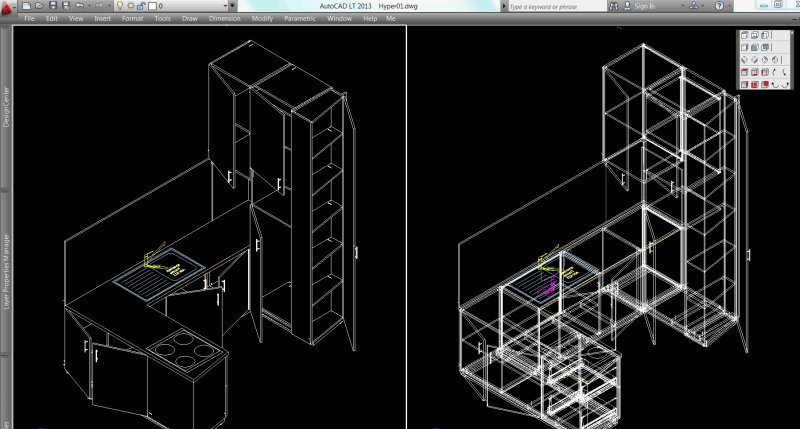

Looking at some ancient artifact I'll be tempted to marvel at how they did 'so much with so little'. Clearly, though, the craftsman kept whatever hand tools they had extremely sharp, and their minds sharper still. Steven, The rigour with which you sharpen your AutoCAD LT experience makes me hope I get a chance to see what you will do with full blown AutoCAD.
You haven't seen what I do with LT yet, :shock:
I've seen enough of your Command Macro prowess to deduce the LISP/VBA/.NET/ARX potential.
To be honest, I can't make any sense of LISP, I have never sat down and studied it closely, but it just looks alien. However I do use Excel and VBA a lot, and as you say macros and diesel. And I really would like to get my hands on full Autocad professionally but in my type of work it is unlikely to happen, the joinery manufacturing industry is being driven to more specialized software packages and away from Autodesk products.
. . . . is being driven to more specialized software packages and away from Autodesk products.
True. Even full AutoCAD is going the way of old wooden hand planes and chisel sets.

Steven-g are the specialised packages being built on top of Autocad or one of the clones or are you talking about the connection to cnc machines etc.

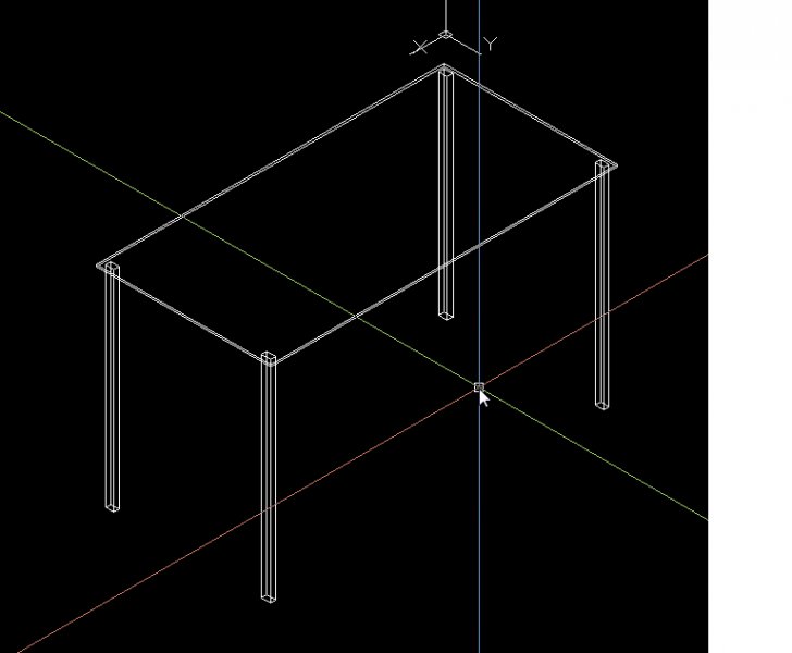

I know you don't have lisp but this code produces a table 3 seconds to draw, for a company would do it with a dcl front end. I know I have seen way better than this here again just a case of joining parts defuns. Please post a dwg would like to see what you produce.
; draw plain bench with legs
; by Alan H Oct 2012
(setq pi2 (/  pi 2.0)) ; 90 degrees
(setq Pt1 (getpoint "\npick lower left corner point"))
(setq L (getreal "\nEnter length"))
(setq W (getreal "\nEnter width"))
(setq thick (- 0.0 (getreal "\nEnter bench thickness")))
(setq pt2 (polar pt1 0.0 L))
(setq pt3 (polar pt2 pi2 W))
; do stuff here like layers for now just draw
(command "rectang" pt1 pt3)
(command "extrude" "L" "" thick)
(setq OF1 (getreal "\nEnter Offset from length for legs"))
(setq OF2 (getreal "\nEnter offset from width for legs"))
(setq leg1 (getreal "\nEnter Hor size of leg"))
(setq leg2 (getreal "\nEnter Ver size of leg"))
(setq thick (+ (- 0.0 (getreal "\nEnter height of legs"))thick))
(setq pt4 (polar (polar pt1 0.0 OF1) pi2 OF2)) ;cnr of leg
(setq pt5 (polar (polar pt4 0.0 leg1) pi2 leg2))
(command "rectang" pt4 pt5)
(setq Cols (- L (+ (* 2.0 OF1) leg1)))
(setq rows (- W (+ (* 2.0 OF2) leg2)))
(command "array" "Last"  "" "R" 2 2 rows cols)
(princ)  ; exit quitely

Just LT but then attributes are exported to excel to create cutting lists and order forms.
