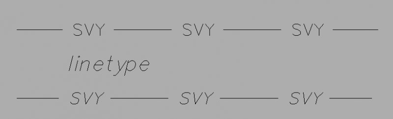

CADMAN57 Posted June 22, 2015 Posted June 22, 2015 Good morning... I'm creating a set of new utility line types for our surveying department. Water lines, sewer, and so forth. They will all have a "W" or "SS" in them, depicting the type of line. I want them to look differently from our civil department's lines, so I am trying to make them with an oblique text style. I created a new text style called Simplex, and used the simplex.shx font type with it. However, the line styles I created don't recognize that I put an obliquing angle on the text style. And, of course, the simplex.shx doesn't allow you to put an obliquing font style on. My problem is that these drawings might be sent to clients who don't have civil 3D, but are using other software, so I don't want to stray from the simplex.shx too far. Anyone have any ideas? Quote
eldon Posted June 22, 2015 Posted June 22, 2015 Try writing some text into the drawing using your obliqued style and then try drawing a line with your new linetype. Quote
eldon Posted June 22, 2015 Posted June 22, 2015 Did you do a Regen? because that is what worked for me. I will post a picture in a while. Quote
CADMAN57 Posted June 22, 2015 Author Posted June 22, 2015 I did...text in both mtext and dtext...nothing Quote
eldon Posted June 22, 2015 Posted June 22, 2015 I started a new drawing from scratch, and created a Text style called simplex using a 15 degree oblique angle. Then I made a layer with a linetype using the simplex textstyle. The first picture is when I drew a line only. The second picture is with some Dtext and a regen. All lines drawn after the Dtext have the obliquing. My AutoCAD must be more magic than yours Quote

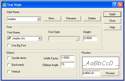

eldon Posted June 22, 2015 Posted June 22, 2015 To go back to your first post CADMAN57 said: ...... And, of course, the simplex.shx doesn't allow you to put an obliquing font style on. I managed to put an Oblique Angle in the text style Effects, not in the Font Style. Is that your problem? Quote
CADMAN57 Posted June 22, 2015 Author Posted June 22, 2015 no....the obliquing angle is there. the problem is the line type doesn't recognize that the obliquing is there. Quote
eldon Posted June 22, 2015 Posted June 22, 2015 if you could post a drawing with only one line of your linetype, I could open it up with my version, and see if I get the same effect. Quote
CADMAN57 Posted June 22, 2015 Author Posted June 22, 2015 good of you to ask, but if you're running 2002, I doubt that's possible. 2002 and 2013 don't play together well... Quote
eldon Posted June 22, 2015 Posted June 22, 2015 Living as I do with an older version, I have DWG Trueview to convert for me. But possibly to save some time, here is my linetype file: *AG_SVY,Survey boundary ----SVY----SVY----SVY----SVY----SVY----SVY-- A,.5,-.2,["SVY",simplex,S=.1,R=0.0,X=-0.1,Y=-.05],-.25 Quote

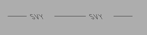

CADMAN57 Posted June 23, 2015 Author Posted June 23, 2015 Neither, actually...found a shape file (gbeitc.shx) that is standard issue in cad, and has an oblique angle out of the box. Works in the line style just fine...thanks for all your attempts....really do appreciate it.... Quote
eldon Posted June 23, 2015 Posted June 23, 2015 Do you want to find out what went wrong with your initial linetype? Perhaps you could post your linetype definition file. Even with the new font, I had to put some text into the drawing first before it behaved itself. Quote
