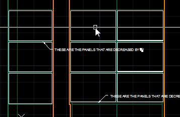

Big Al, not to be a pain in the butt, but can you expand on how to use the lisp file? I've saved it, run appload and tried to use it, but not quite sure how. I've tried quite a few different ways but without reliable results.

I thought you didn't want to draw the panels because it would clutter up your drawings.
I believe that I was speaking of the lines I would use to offset the length of the panels by 1/2" overall.
The code is only say the 1st part in about 4 steps of coding, it seemed to make sense to me that you wanted the size of a panel that fitted within a certain area minus 1/2". ps I work in metric. If you draw a sq 10x10 feet or metric appload the lisp even paste it direct to the command line, it asks for a point just pick in middle of the 10x10 sq a 2.5 offset object will appear. I turned off a number of layers in your drawing to get what I thought was the required panel area, it must be a enclosed area a "U" will not work the Bpoly is an Autocad command Boundary polygon so works basicly for any internal shape including curves. I drew 9 panels in 1.5 secs as fast as I could pick.
Next 5 steps of coding
work out from rectang the length and width
the 2 points for the new dims
erase the bpoly no longer required
draw the dims or lines or both its up to you on correct layer
pick next location
The white squares are on layer 0 they represent your 1/2" inwards change the value 2.5 in the code to 0.25 that was just for me testing I changed the drawing units to feet and 0.25 gives 1/4" egde.
I am not sure that I have isolated the correct panel areas that is something you need to look at. Is it meant to work from the middle of the double lines etc ?
