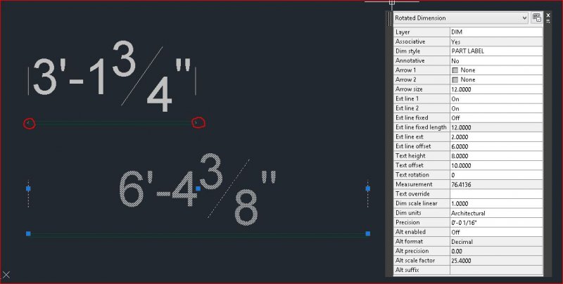

Dadgad Posted June 23, 2015 Posted June 23, 2015 (edited) It would be very easy to create a Dynamic Block to replace the Partition Multiline Style which you now use to draw your partitions, in locations where you need to maintain that 1/2" fitting factor. It might look like the one in the screenshot, which is just a rectangle of 3/4" thickness with 1/4" polylines in the middle of each end, they are on a non-printing layer. A simple STRETCH parameter/ action on both the dimension and the end point or points. No doubt there are plenty of more clever ways to do it, but that is one simple approach. Edited June 23, 2015 by Dadgad Quote

BIGAL Posted June 24, 2015 Posted June 24, 2015 Ok my suggestion turned off all but 2 layers, partion and hallway, using a lisp my understanding is you want a panel within these areas, very simple bpoly will make a pline to this shape its then a matter of shrinking the corners by 1/4" and you have your panel. The user input would be isolate layers then pick pick pick you would just see panels appearing, you can do all sorts of smart things like dimensioning etc as part of this lisp routine. Come to think of it offset last 1/4" towards pick point erase 1st bpoly and done. Quote
BIGAL Posted June 24, 2015 Posted June 24, 2015 Way easier than I thought, remember steelcom ask nicely in future. (setvar "clayer" "0") (while (/= (setq pt (getpoint "\npick centre <Cr>. to exit")) nil) (command "bpoly" pt "") (setq obj (entlast)) (command "offset" 2.5 obj pt "") ; change offset value (command "erase" obj "") ) Quote
