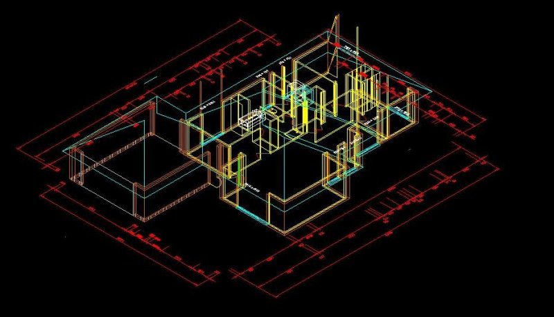

We use a version of a mline that draws the 4 lines in one go and on different layers, also internal walls as 2 lines, with smart join and trim routines sorry all copyrighted. I apologise for posting this image again, need to make a new one. This is all plain jane autocad.
If you are an experienced AutoCAD user it's possible you could do this using a continuous polyline for the footprint of the building then offset the required distance for the wall. Then you can use lines or polylines for the interior walls.

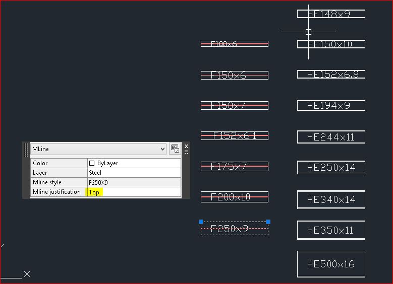

I really like MLINES, and think that they are under utilized by most users, although as RK points out, there are some issues when using them.

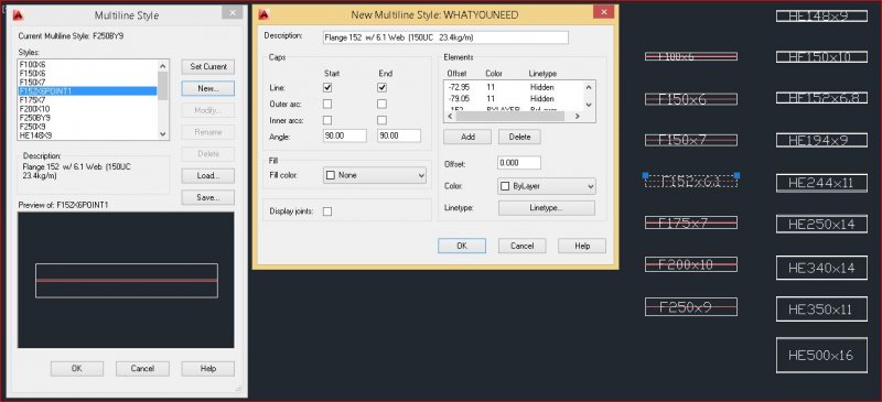

I have a small library of Mlines I made up for drawing common steel profiles, but I rarely use them because I tend to use SOLPROF instead from 3D Models.
If all of your exterior walls are 6", you could quickly trace around your footprint with a multiline and create them, remember that you are in charge of the display justification, meaning relative to the base line you draw.
If you look at the options for Multilines, you have a fair amount of control over them, when creating and defining the style.
In the screenshot you can see those steel profile multilines which I include in my default .dwt, so if I need them, I remember which ones are available. The more elements included in the multiline, the more valuable it becomes, for a double line, OFFSET is pretty hard to beat. In the flange view multilines in my screenshot, you draw the web at the same time as the flange by drawing a single line, which is extremely accurate and fast.
