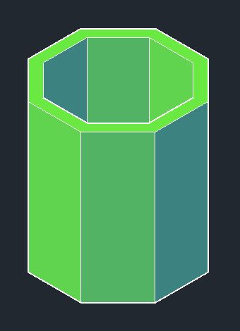

I am trying to create a hollow section much like an octagonal pipe. I can create the 2D image of the "OD" and "ID", but I am having issues with creating the Solid or surfaces and then cutting, subtracting, or creating a shell.
What is the best process for performing this action?

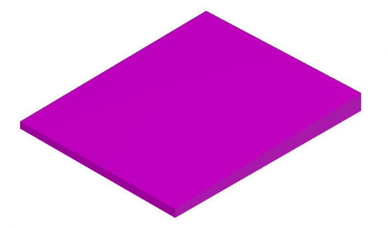

Also, I am attempting to create a Solid plate that is not "flat", i.e. the surfaces are not level with the XYZ planes but actually tilted slightly. What is the best way to perform this Solid creation?

Re: octagonal pipe. Something like this?
Re: tilted plane. Is this what you are referring to? While the bottom is flat the corner heights are all different thus giving the top plane a cross pitch.
The octagonal pipe you have attached is right on the money.

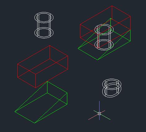

As far as the plates are concerned, here is the lowdown: I have survey data (X,Y,Z) for the exposed surface/corners. I am trying to take this data and create a surface/plate and then lower/attach the Octogon to the plates. With this I hope to show/visualize the shim thicknesses required and how these shims will need to be installed.

Use the POLYGON command to easily generate the octagon, follow the commandline prompts carefully.
OFFSET that polygon by the required thickness of the wall, in the appropriate direction, then use PRESSPULL to create the solid, follow the commandline prompts.
Watch this short video, and it will all become crystal clear.
http://www.cadtutor.net/tutorials/autocad/extrude-and-press-pull/

If you make 2 3d objects you can use "subtract" to slice the bottom of the tube, using the same idea make a 3rd flat object and set it the highest point of the sloping plane subtract top and bottom from tube this will be shim.

I know the basics of 3d enough to be dangerous. Hope this helps
Edited by BIGAL
[ATTACH=CONFIG]54658[/ATTACH]
BIGAL, that pretty well sums it up as stated. :beer:
