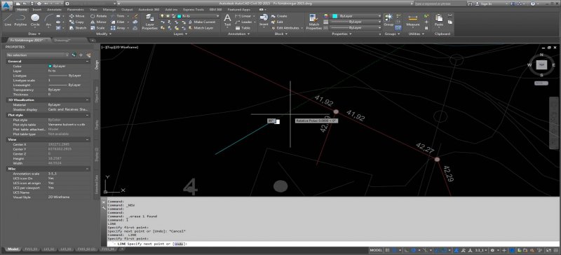

I have Dynamic Input on and Polar Tracking is set to Relative to last segment, I have a line drawn. I start the LINE command, klick on the End of the already drawn line and want to draw a new line in the same direction as the old one - so I move the cursor in the general direction and Relative Polar kicks in, and I type the distance aaaaand nothing happens.
At the cursor I can read "Relative Polar 0.000

You can see the white box right where the line ends, that is the box that you type in when you write a distance, but nothing happens. What comes out is a line with 0 length.
