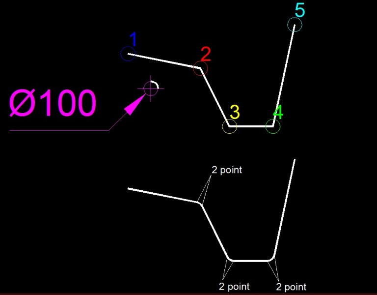

Hello
I would like to create polylines not using the command, have data point (1,2,3,4,5) as the attachment sketch and diameter bending.
How to calculate the start and end points of the arc regardless of the direction and the correct value bulge
First calculate the position of the arc endpoints & center (based on the adjacent polyline segments and the required arc radius), and then the bulge for the arc segment is equal to the tangent of a quarter of the included angle.
Refer to my Bulge Conversion Functions for more information.
Hi, Thank you for interesting reading. It turns out that my problem that I have overcome the first calculations are ordinates in a coordinate system.I hope that soon wish to train.
I started by writing a function of calculating the angle between the vectors. Unfortunately, it seems to me that somewhere in my reasoning is wrong . Could you look at the function below.

1st question do you want one radius for all if so then search here the code for that is done. Also re angles its best to work in radians as this is the default for autocad but be aware zero is to the east and they are measured clock wise.
You can get the co-ords of a pline as a list so you would just take pt1 pt2, pt2 pt3 to get angles in lisp (angle pt1 pt2)

something like this its a two point pick
jan_ek
Jan,
Simply use the angle function.
(defun ang3p (p1 p2 p3 / a)
  (or 2pi (setq 2pi (* 2 pi)))
  (abs (- (setq a (- (angle p2 p1)(angle p2 p3))) (* (fix (/ a pi)) 2pi)))

Look Jan, if you are trying to fillet polylines with circle at their vertices, try this code :

Consider the following code:
(defun c:fpoly ( / idx rad sel )
   (initget 6)
   (if (and (setq rad (getdist "\nSpecify fillet radius: "))
            (setq sel (ssget "_:L" '((0 . "LWPOLYLINE"))))
       (repeat (setq idx (sslength sel))
           (LM:filletpoly (ssname sel (setq idx (1- idx))) rad)
;; Fillet Polyline  -  Lee Mac
;; Attempts to apply a fillet with a given radius to all vertices of a given polyline
;; ent - [ent] LWPolyline entity
;; rad - [num] Fillet radius
(defun LM:filletpoly ( ent rad / enx hed lst )
   (setq enx (entget ent)
         hed (reverse (member (assoc 39 enx) (reverse enx)))
         lst (mapcar 'cdr (vl-remove-if-not '(lambda ( x ) (= 10 (car x))) enx))
         lst
       (apply 'append
           (apply 'mapcar
               (cons
                  '(lambda ( v1 v2 v3 / a1 a2 a3 di tn )
                       (if (and v1 v2 v3
                               (setq a1 (angle v2 v1)
                                     a2 (angle v2 v3)
                                     a3 (rem (+ pi pi (- a1 a2)) (+ pi pi))
                                     a3 (- pi (min a3 (- (+ pi pi) a3)))
                                     tn (tan (/ a3 2.0))
                               (not (equal a3 0.0 1e-8))
                               (setq di (* rad tn))
                               (<= di (/ (distance v2 v1) 2))
                               (<= di (/ (distance v2 v3) 2))
                           (list
                               (cons 10 (polar v2 a1 di))
                               (cons 42 (tan (/ a3 (if (gc:clockwise-p v1 v2 v3) -4.0 4.0))))
                               (cons 10 (polar v2 a2 di))
                           (list (cons 10 v2))
                   (if (zerop (logand 1 (cdr (assoc 70 enx))))
                       (list (cons 'nil  lst)      lst (append (cdr lst) '(nil)))
                       (list (cons (last lst) lst) lst (append (cdr lst)  (list (car lst))))
   (entmod
       (append
           (subst
               (cons  90 (length (vl-remove-if-not '(lambda ( x ) (= 10 (car x))) lst)))
               (assoc 90 hed)
               hed
           lst (list (assoc 210 enx))
;; Clockwise-p  -  gile
;; Returns T if p1,p2,p3 are clockwise oriented
(defun gc:clockwise-p ( p1 p2 p3 )
   (< (sin (- (angle p1 p3) (angle p1 p2))) -1e-14)
;; Tangent  -  Lee Mac
;; Args: x - real
(defun tan ( x )
   (if (not (equal 0.0 (cos x) 1e-10)) (/ (sin x) (cos x)))
You might also be interested in this thread.
