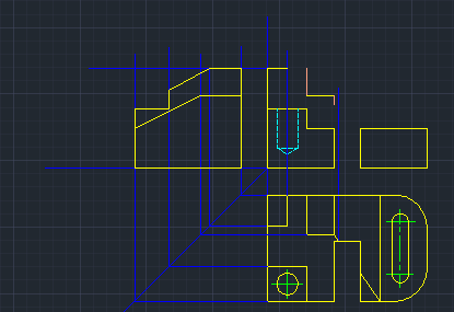

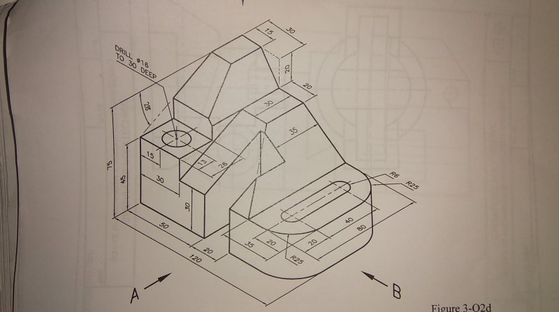

Hi! I am stuck with this question for almost 3 hrs. May I ask if there are any kind soul who can provide me with the 1st angle projection of the attached image? I have attached my working and as you can see, Im stuck...
Take A as Front View.
B as Right End View.
And Plan View from A
Thank you very much.
Much appreciated. :D
