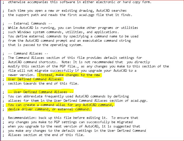

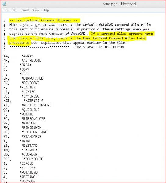

Dadgad Posted June 13, 2015 Share Posted June 13, 2015 (edited) I don't mess with the pgp file. I am pretty new at this (7 years), and perhaps there was a time when the .pgp was somewhat more daunting, but these days, have no fear. If you should be so bold as to open your .pgp file, TOOLS (in the Menu Bar) down near the bottom of the list CUSTOMIZE then click EDIT PGP, and your .pgp will open in Notepad. If you scroll all the way to the bottom of that long list of stuff you will come to the area intended to be for personalization, as shown in the screenshot. In a new install, it will be empty, awaiting any custom shortcalls you would care to add. There is no need to edit anything above this section period. Later after entering any personalizations, in the format as shown, you need to SAVE the .pgp. After making some additions use REINIT command to put them into immediate service without the need to reboot. The next time you migrate to a newer version, all of these customizations will be brought along for the ride automagically, and they will trump the default aliases which are above this section, should there be any conflict. Meaning, that if you use an alias which has been used in the default ootb list, for something else, it will be accepted and changed to your specification. Still got cold feet? There is another even easier way, the ALIASEDIT command, which will do the exact same thing for you, but without the need to open the dreaded .pgp, it will all be done from a small onscreen dialog box. Just be sure to CONFIRM any changes before closing the dialog. This command will write them into that same USER DEFINED ALIASES section, no muss, no fuss. I too use the toolbars, and it sounds to me like you may be unfamiliar with all of the wonderful tools available on the LAYERS 2 toolbar. Check them out, you'll be glad you did. You might just run into a few old friends, as well as make some new (Layer Walk is cool) ones. Edited June 13, 2015 by Dadgad Quote Link to comment Share on other sites More sharing options...
