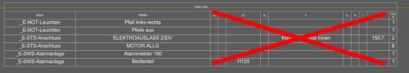

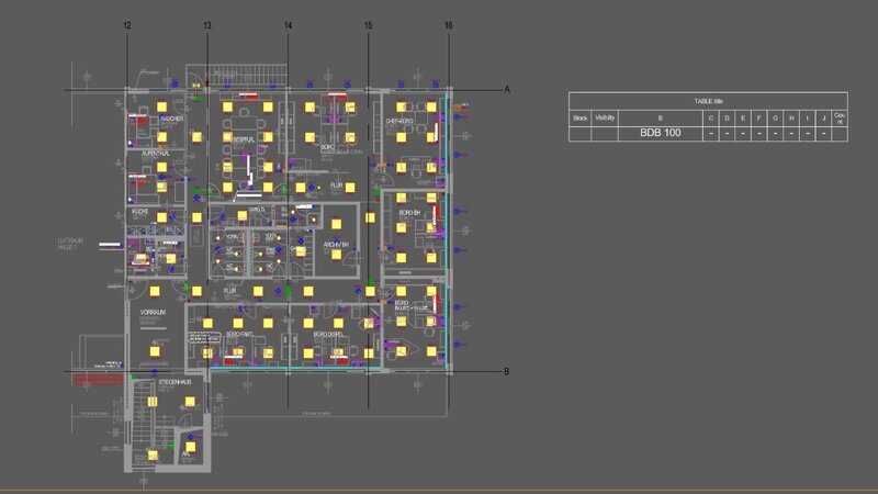

It would also be possible to read the visibility of dynamic blocks.
Simple answer yes.
1st step get a copy of Lee-mac.com Dynamic block functions.
2nd step
(setq obj (vlax-ename->vla-object (car (entsel "\nSelect a dynamic block "))))
