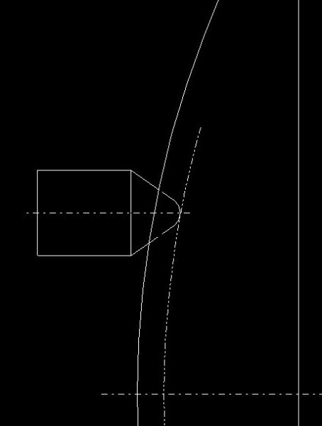

90eagleTSI Posted June 8, 2015 Author Posted June 8, 2015 Wow, so many reviews and still nothing. Just want to note that the engraving should be perpendicular with the cup though out the engraving (see attached image). Yes, I know some say to use the emboss function but I have and it does not give me the result that I need. Quote

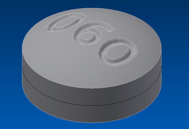

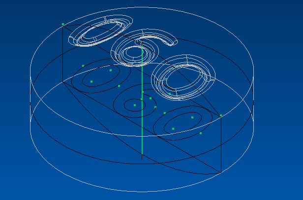

ecshclark Posted June 9, 2015 Posted June 9, 2015 Center cross geometry on plane Revolve cross section of pill Center text geometry on plane perpendicular to cross section Emboss text onto curved surface. Offset interior islands to depth Draft island sidewalls of emboss feature at 35 deg. Draft outer sidewalls of emboss feature at 35 deg Fillet bottom corners of emboss feature Round upper corners of emboss feature Mirror all features excluding cross section. Quote
90eagleTSI Posted June 9, 2015 Author Posted June 9, 2015 ecshclark THank you very much but I am good up to the point of Draft the sidewalls I am not certain to what I am doing wrong but its not working correctly or as I assume it would be. Have you worked this out yourself in inventor and did it work? Again this was the route I approached but did not succeed. Thank you very much! ecshclark said: Center cross geometry on planeRevolve cross section of pill Center text geometry on plane perpendicular to cross section Emboss text onto curved surface. Offset interior islands to depth Draft island sidewalls of emboss feature at 35 deg. Draft outer sidewalls of emboss feature at 35 deg Fillet bottom corners of emboss feature Round upper corners of emboss feature Mirror all features excluding cross section. Quote
ecshclark Posted June 9, 2015 Posted June 9, 2015 Attached are pics of the pill I modeled. Easy, peasy Quote
90eagleTSI Posted June 9, 2015 Author Posted June 9, 2015 Awesome, I now know it works. I will have to attempt this method again and try to find my issue. Quote
ecshclark Posted June 9, 2015 Posted June 9, 2015 Make sure you pick the top edges of the emboss feature when appling draft. As you move the cursor around you should be able to see a darker/heavier hi-lighted edge where the draft will start. And you see a little triangle showing the direction of the draft. Quote
