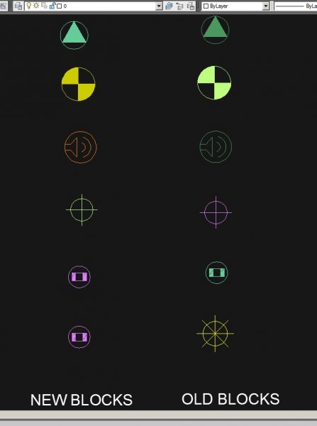

Hello Tharwat,
Thanks for the reply.
I tested the lisp on several files, but I get the same result. After run the lisp, i was expecting old blocks replaced with new blocks. It replace the blocks but not applying property of the blocks.
I attached the one of the sample file I used for testing. attached test.lisp which is listed below.
I added old block names (imported -A, B,C..) and new blocks names (new-A,B,C..) on the list.
Is there any setting i'm missing?
I'm currently using Autocad 2014 and save the file in 2004 version.
Once again, thank you very much for the responds.

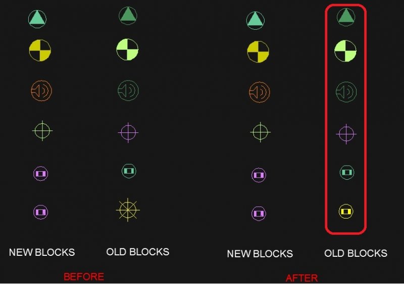

Hi,
I can modify the program to make it working as in your attached drawing but what would happen if you have two block references of the NEW block and there are on different layers?
If you use the program Replace Block with another block from the Express Tools, I think that should help in your case. otherwise you should have only one NEW block existed in the 'lst' variable and it does not matter how many OLD block references you have in your drawing.

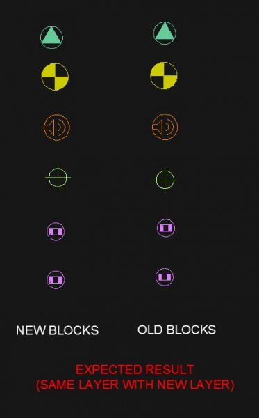

Hello Tharwat,
"you should have only one NEW block existed in the 'lst' variable and it does not matter how many OLD block references you have in your drawing."
It is correct, each new blocks (reference block) will have a unique name.
Currently, the blocks are replaced but it kept property (layer) of old blocks.refer to "BLOCK REPLACE SAMPLE BEFORE AND AFTER.jpg" (the way express menu does)
I prefer if it could replace block and layers as shown on "PREFERRED BLOCK REPLACE .jpg"
Once again, thank you for the reply.

Hi,
You did not get my point.
Suppose you have two block references in your drawing and each one of them on a different layer so which layer name the program should pick to assign it to the related old block reference in the list?
Hello Tharwat,
If that happens, i think it is ok to pick any layers or cancel the lisp whichever is easy.
Maybe I'm not fully understand, but all reference blocks will be unique in the beginning.
For example, there will be only one "NEW - A" block and "NEW - E" block in the drawing.(I added "New - E" on the sample to show the relationship. )
If there are multiple "NEW - E" blocks on the drawing because the "New - E" block is used for a reference block and replaced other blocks, all "New - E"blocks should have same layers.
Is it clear?
Let me know.

Hi,
Please try the following and let me know:
