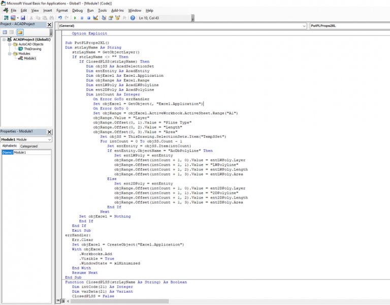

SEANT Posted February 7, 2018 Posted February 7, 2018 Works okay with 2018. Is you project setup something like this? Quote
xxfaxx Posted February 7, 2018 Posted February 7, 2018 sorry, my bad i was using visual basic from excel, but now using it from autocad i can make the command work except with one little thingy. After i select an entity on a leyer with which to focus, i get a new error "run-time error 91, object variable or with block variable not set", and when i click the "debug" option this part "Set objRange = objExcel.ActiveWorkbook.ActiveSheet.Range("A1")" gets highlighted in yellow... I suspect i am still doing something wrong. Quote
xxfaxx Posted February 7, 2018 Posted February 7, 2018 I could make it work somehow but i cannot select the objects i want.. I mean, when i activate the command, the information goes right to excel just like that. no preselection.. well, im still learning. I changed your code a tiny bit to get the info in the cell i want. thanks Quote

xxfaxx Posted February 9, 2018 Posted February 9, 2018 the piece of code i edited was this one Set objRange = objExcel.ActiveWorkbook.ActiveSheet.Range("A1") I changed that to this [code]Set objRange = objExcel.ActiveCell [/code] And that allowed me to get the information to a cell in excel that i had clicked previously, instead of getting the info on the first cell.. i know it is not much of a change. Trying to understand something from all that code (without knowing anything) is quite a challange. thanks for the link. i will check it out Quote
