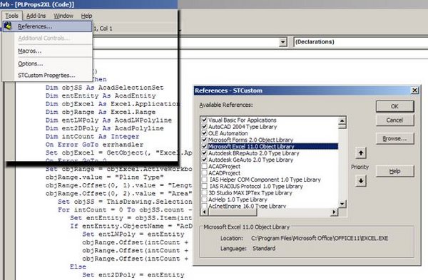

Here is some VBA code cannibalized from a larger routine (i.e., may need further tweaking) that basically does what you request. It automatically selects all closed polylines - Lightweight, 2D (fit or splined) - and sends information to a generic excel file.
The VBAIDE must have a reference set for your version of Excel.

Thank you for your reply....
I try your vba but, it shows error... i thing, the reason is excel version...
I am using the Excel 2002 and auto cad 2004..so, pls help me for this version..
Thanks & regards
A reference to the proper vesion of Excel can be set through Tools-Reference menu item (as illustrated). I'm using Excel 2003 so, presumably, you would select the "Microsoft Excel 10.0 Object Library"
If that was not the cause of the error, post the actual error message and we'll try to work it out.
Now, it is working friend.....thanks youuuuuuuuuuuuuu....

Here is an updated routine to add the feature like that of the Lisp code. I hope it is helpful.
An observation should be made about this web site and the “Helpfulness” of all of its members. It’s quite clear that we all enjoy helping out where we can. This is a site based on teaching and learning, however, so the ultimate goal is to help others learn the various aspects of AutoCAD.
With regard to Lisp or VBA, a level of helpfulness and responsiveness too high could help a person not learn programming.
The routine accompanying this message may not be suited for a tutorial in VBA (or maybe it is), but it should allow for specific coding questions. I’ll do what I can to answer those questions if you need to make further modifications to the code.
   Option Explicit
Sub PutPLProps2XL()
Dim strLayName As String
  strLayName = GetObjectLayer()
  If strLayName <> "" Then
     If ClosedPLSS(strLayName) Then
        Dim objSS As AcadSelectionSet
        Dim entEntity As AcadEntity
        Dim objExcel As Excel.Application
        Dim objRange As Excel.Range
        Dim entLWPoly As AcadLWPolyline
        Dim ent2DPoly As AcadPolyline
        Dim intCount As Integer
           On Error GoTo errHandler
           Set objExcel = GetObject(, "Excel.Application")
           On Error GoTo 0
           Set objRange = objExcel.ActiveWorkbook.ActiveSheet.Range("A1")
           objRange.value = "Layer"
           objRange.Offset(0, 1).value = "Pline Type"
           objRange.Offset(0, 2).value = "Length"
           objRange.Offset(0, 3).value = "Area"
              Set objSS = ThisDrawing.SelectionSets.Item("TempSSet")
              For intCount = 0 To objSS.count - 1
                 Set entEntity = objSS.Item(intCount)
                 If entEntity.ObjectName = "AcDbPolyline" Then
                    Set entLWPoly = entEntity
                    objRange.Offset(intCount + 1, 0).value = entLWPoly.Layer
                    objRange.Offset(intCount + 1, 1).value = "LWPolyline"
                    objRange.Offset(intCount + 1, 2).value = entLWPoly.Length
                    objRange.Offset(intCount + 1, 3).value = entLWPoly.Area
                 Else
                    Set ent2DPoly = entEntity
                    objRange.Offset(intCount + 1, 0).value = ent2DPoly.Layer
                    objRange.Offset(intCount + 1, 1).value = "2DPolyline"
                    objRange.Offset(intCount + 1, 2).value = ent2DPoly.Length
                    objRange.Offset(intCount + 1, 3).value = ent2DPoly.Area
                 End If
              Next
     Set objExcel = Nothing
     End If
  End If
  Exit Sub
errHandler:
  Err.Clear
  Set objExcel = CreateObject("Excel.Application")
  With objExcel
     .Workbooks.Add
     .Visible = True
     .WindowState = xlMinimized
  End With
  Resume Next
End Sub

I try use your code with VB ver. 6.3 ,Excell 2003 and this message appear :
"User-defined type not defined" at line Dim objExcel As Excel.Application
:oops: As you see am begginer with VB.What can i do ?
Thank you.

See post #6 in this thread. It may be related to the problem you describe.
You say you're using VB 6.3; do you mean Autocad VBA 6.3 or VB6. If it is the latter, you're will likely run into a few more problems with the code above as all of the Autocad objects will need modification.

I have a problem
when i try to use it i get an error "Compile Error:Variable not defined"
and this part of the code gets highlighted with yellow
"Function FilteredSS(Optional grpCode As Variant, Optional dataVal As Variant) As Integer"
i already did what you said in the post #6
It has been a long time since I fired up the ol' VBAIDE. I copy and pasted the code, and set the appropriate references (Microsoft Excel 16.0 Object Library) and the code seems to run fine.
Is it possible that when you transferred the routine that some part of the code did not get copied along?
nope, i cheked it twice
im using autocad 2017 and excel 2010. maybe there is the problem.
